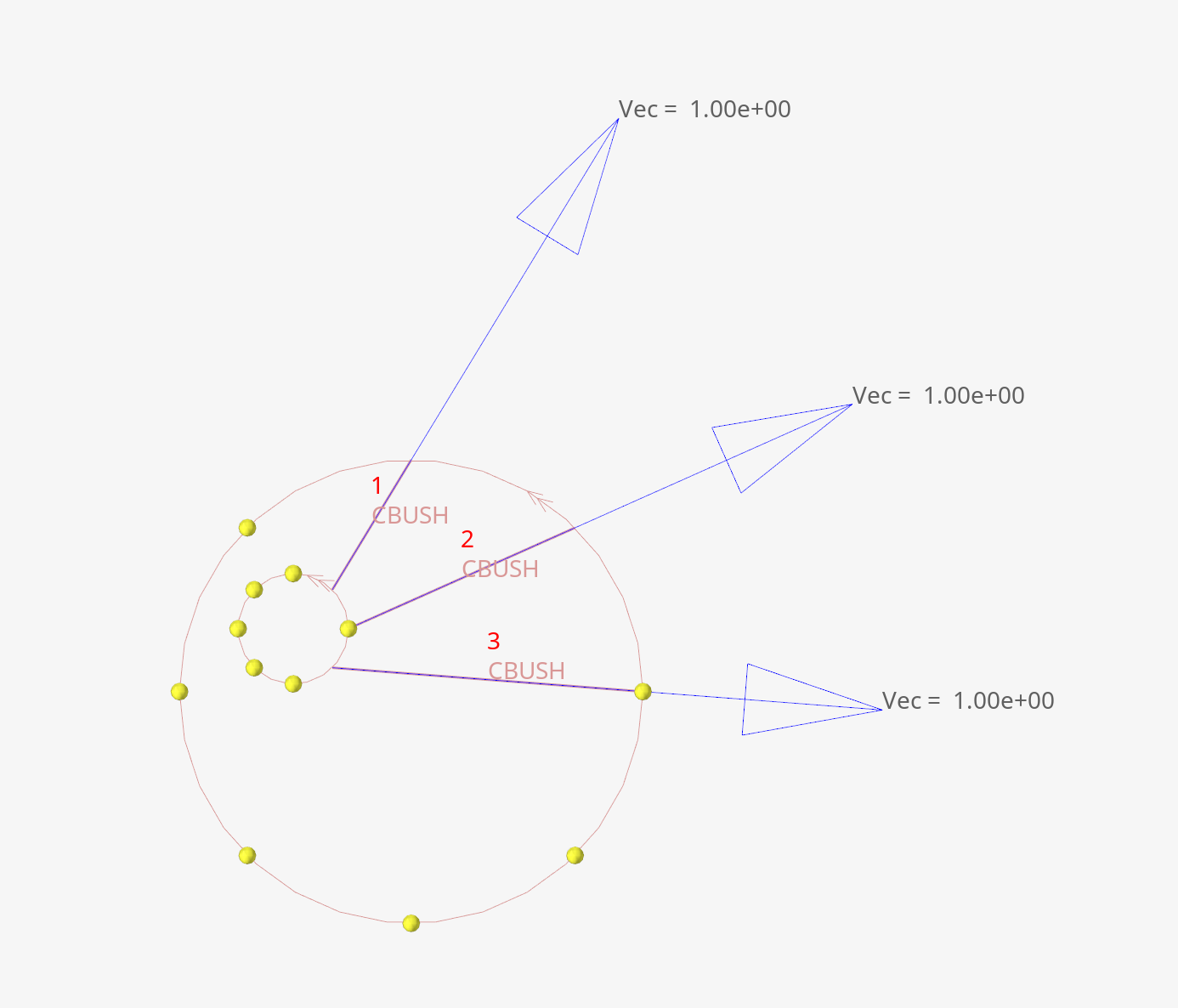

Overview: If you have many CBUSH elements with the same orientation, this is easy to define, but if each CBUSH has a different orientation, you will need to define as many CBUSH elements as you have.
This script automatically assigns the length direction of the selected CBUSH elements as the default Vector, so you can quickly define the CBUSH Orientation.
Step 1) Check the Orientation of already created CBUSH elements.
Step 2) Run the script and Select the entities with CBUSH elements
Step 3)
The direction value is entered based on the CBUSH element's length direction.
