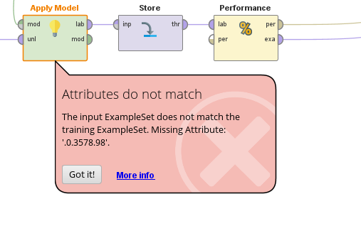

I'm trying to get the sentiment scores of reddit comments via Naive Bayes but i'm getting an error at the "Apply Model" operator. I hope someone can tell which step is causing the error.
Error:

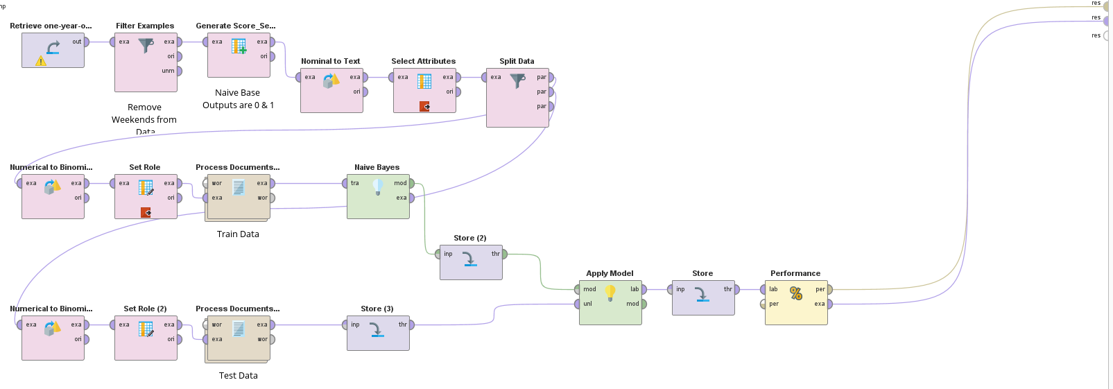

Process: (I have a "Tokenize" Operator inside the "Process Documents from Data" Operators)

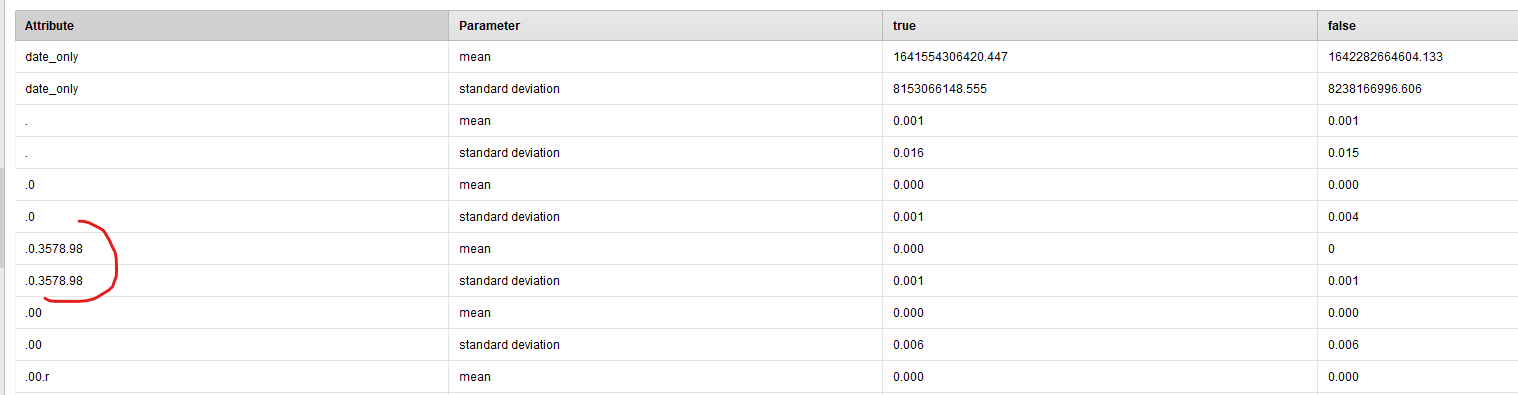

Train Data Output after "Naive Bayes" Operator: (Those numbers are shown in the error..)
Error:

Hi,
you want to connect the wor output port of the upper process documents with the wor inputport of the lower one. This way the same columns are created.
BR,
