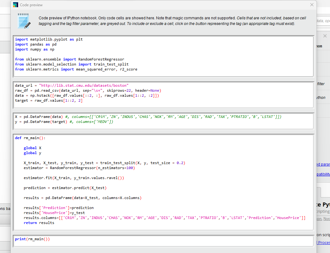

I'm trying to practice Python in RM by linking the ipynb script.
However, the variable name of the sample data is not what I want, so I am trying to change the variable name and print it.
There is no error when the variable name is not changed, but an error occurs when the variable name is changed.
I just changed the variable name. What on earth does this error have to do with it?
I am attaching the code I wrote and the error message.

Hi @YunJeong_Kang,
Your issue stems from the second to last line, where you rename the column headers. The error message lets you know that you're passing a tuple which is an incorrect type. I would recommend either renaming outside of the Execute Python operator using the Rename operator, or modifying the command. I believe the fix is to remove the outer square brackets (I have tested this, and it works for me).
