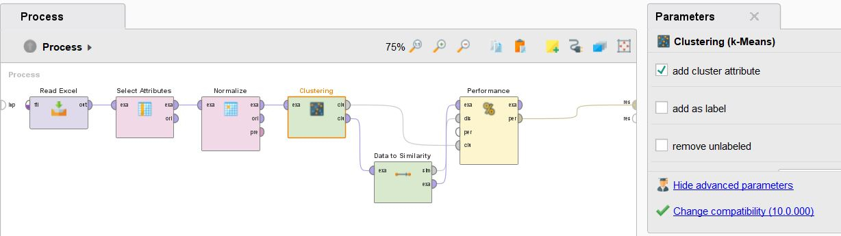

I can easily do it with K-Means:

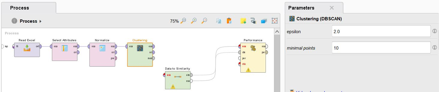

But I can't fit the DBSCAN block in place of the K-Means block. The outputs are different and there is no "Cluster Model" to feed the Performance block.
The old version of DBSCAN block has the same gates of K-Means, but now it is changed, as shown in the figure. In all tutorials I found the old version is used.

Hi @SteveZ ,
thats sadly a known issue and in our ticketing system, but sadly this won't change quickly.
BR,
Martin
