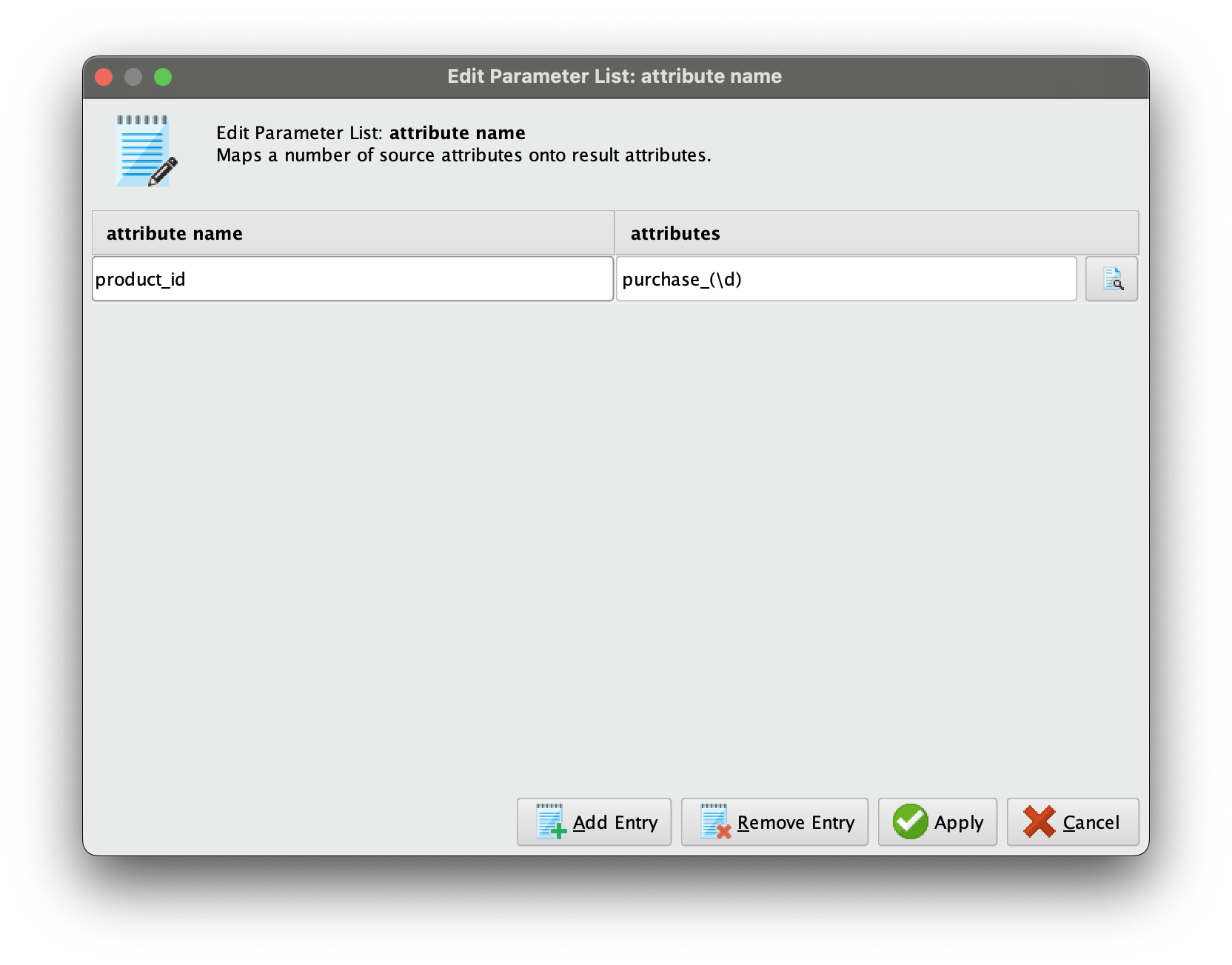

The depivot is configured as so:

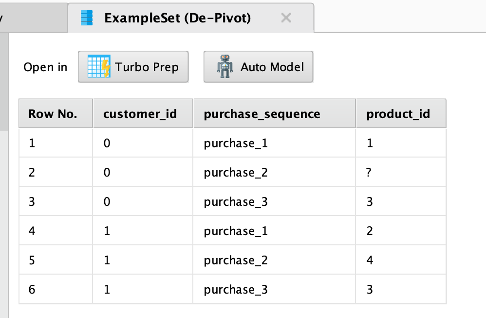

and yeilds exactly what I'd expect and creates a new product_id row:

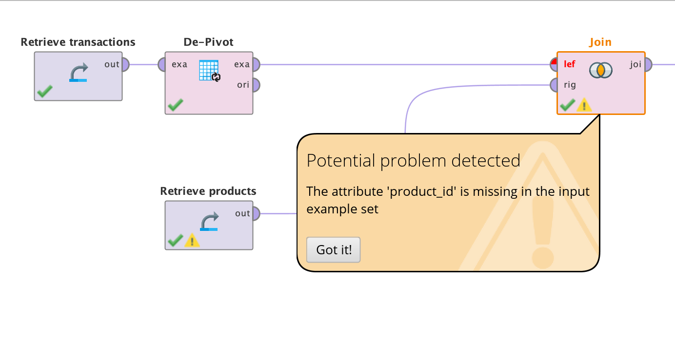

However, when I try to input the result of this unpivot to the join operation, I'm getting a warning about the product_uid missing in the de-pivot output.
When I execute the process, the join seems to work
Shall I just disregard this warning message?

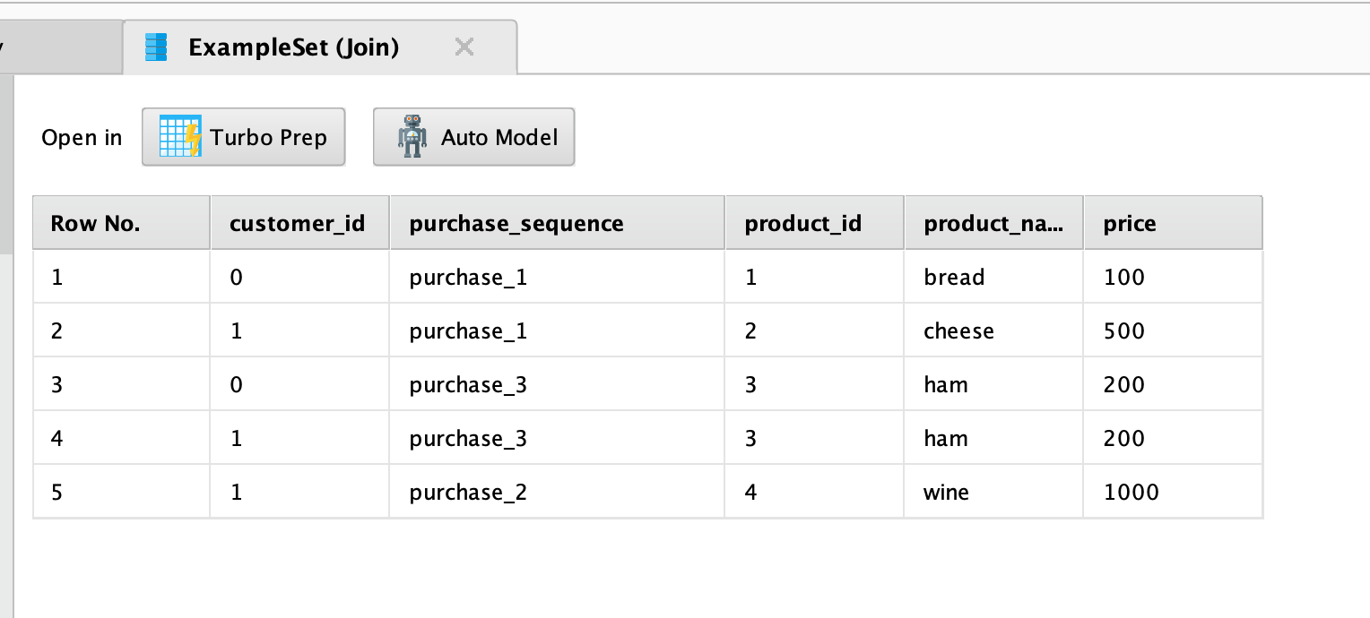

Actually there seem to be an issue when I want to use the result of the join from that de-pivoting It seem like the join does not output does not include anything from the product table:. Here you can see that the price attribute is not displayed. I also cannot reference it in any of the subsequent operation
