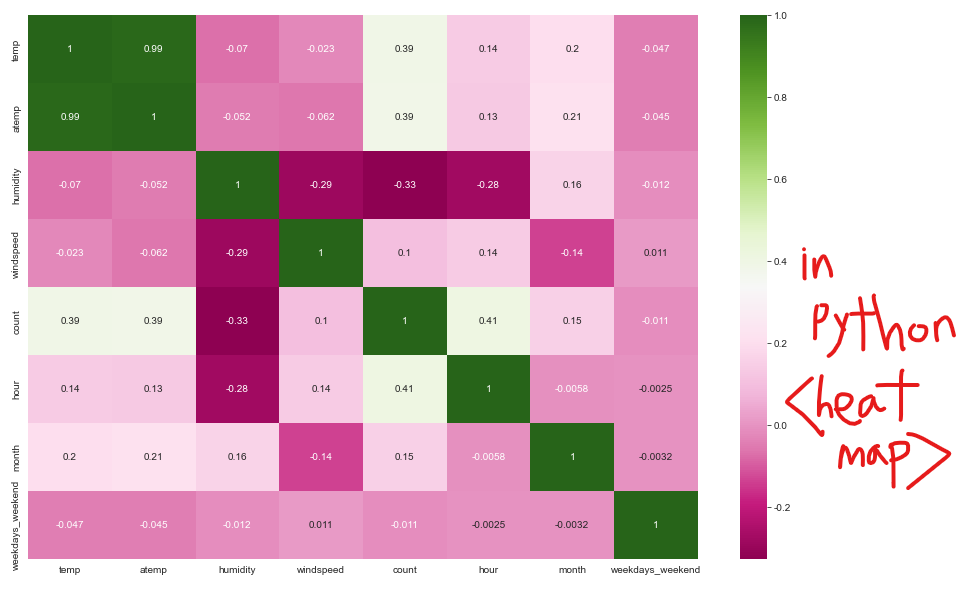

In Python, when I calculated VIF (multicorrelated), it was found that 'holiday - workingday', 'temp - atemp' and 'month - season'  were highly correlated.
So I was able to remove one of the two variables.
But, in Rapidminer, as a result of on of the variable with a high correlation using 'Correlation Matrix' and 'Remove Correlated Attributes' operators, only  'atemp' among 'temp - atemp' was removed.

Plus, please let me know if you can tell me how to check the visualization that tells me the correlation figures of the two independent variables, such as Python's heatmap in Rapidminer.

    for heatmap visualization you have two options.
    first, when you use the Correlation Matrix operator it provides you a heatmap visualization option:
    if you want to work with the resulting data you can use the Matrix to exampleset Operator and then create your own heatmap with the data:
    I hope this can help you.
