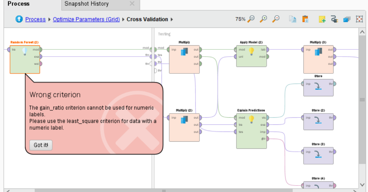

I trying to run a optimization grid with our my Random Forest model and I am getting an error.  It's stating that gain_ratio criterion cannot be used for numeric labels (see pictures below).  I checked all my parameters and I am not using gain_ratio in the optimization grid (see pictures below).  So, specifically how you used a optimization grid with cross validation, and random forest predicting a real number in RapidMiner?

    can you show us your optimization settings? Likely you use least_square there.
    Also: Be careful using Explain Pred in the X-Val. This can take enormous amount of time.

    Please see below.  Also, I am sending the results of the optimization to a log.  Let me know what this issue is or an example workflow process of how this works in RapidMiner.
    Hi,
    you have a numeric label and try to vary the gain metric between [information_gain,gain_ratio,gini_index,accuracy]. This has to not work, since those are all metrics which don't work on numeric labels.

    Hi!
    Just select correct and applicable settings for the optimization. Leave the criterion alone (it has to be least_square for numerical prediction) and optimize parameters like the number of trees and the maximum depth.

    I am using least_square in the Random Forest decision tree and it's still giving me an error (see below).  I still don't understand why it's not working.  Please educate me on the specific, step by step, how-to instructions to make this work.  Thank you much.
