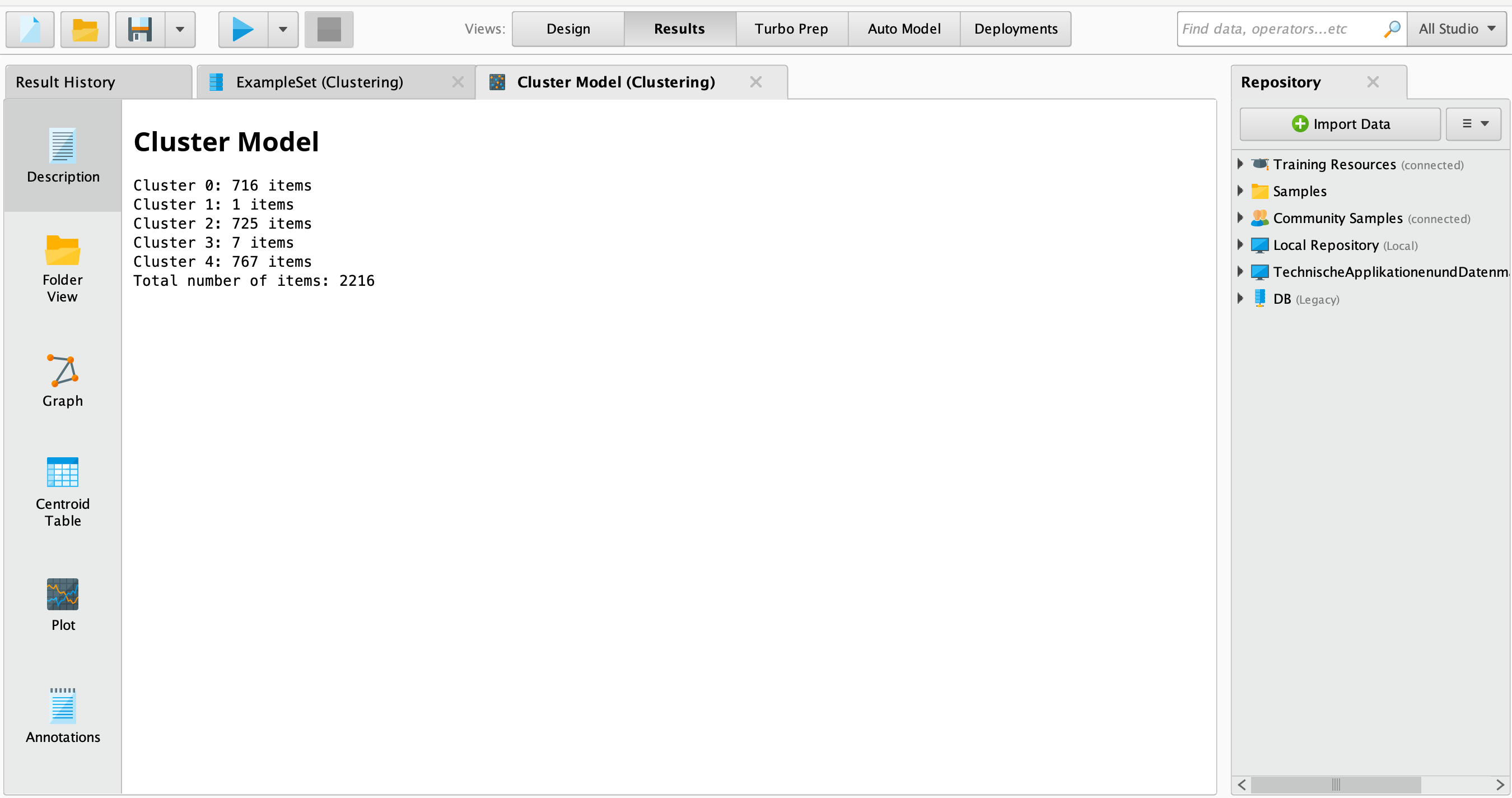

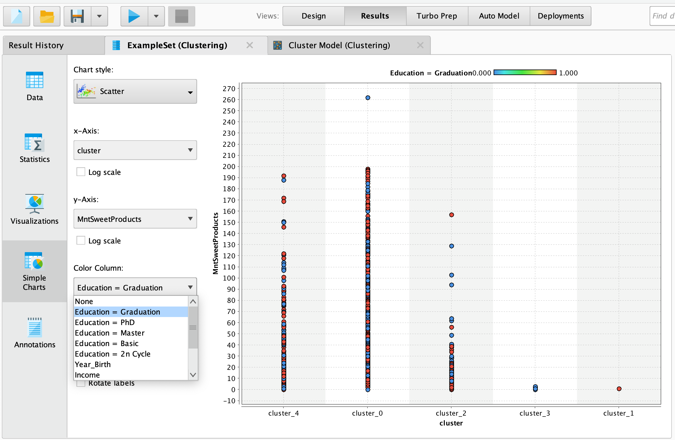

I want to answer the question, whether the "education" (5 different types are available) has an impact on the "amount sweet products". Therefore I want to analyze with the clustering (k-means) the amounts of sweets being purchased and afterwards understand the education behind the amounts.
  • In the below screenshot you can see 5 different cluster. How do I understand their meaning?
  • Will I have to compare 5 different charts as I have 5 different types of education? (The chart looks the same when I chose a different eduction type for "color column", only the color get different)
  • I have more than 2000 rows. Is it necessary to prepare the data so I have n=1000 to get a better and more precise result?
  • What does the "Cluster Model" mean? I would have expected 5 different cluster where the amount of items rise (e.g. cluster 1= 5 items, cluster 2= 349 items, cluster 3= 500 items)
