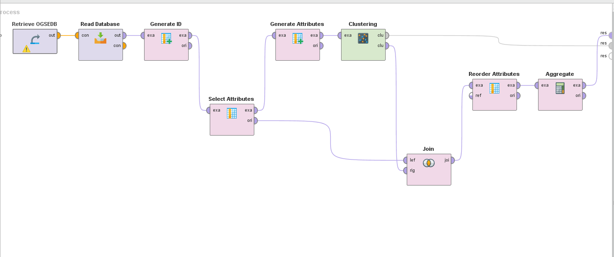

I show the small process that I have set up right now.
In this case I deal with signals from a transmitter. I have 6 parameters. RF_min, Rf_max, PRI_max, PRI_min, PW_max, PW_min.

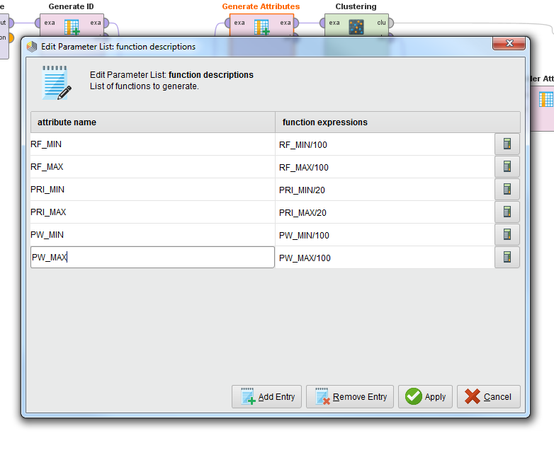

This is how I choose the weights in the generateAttributes operator:

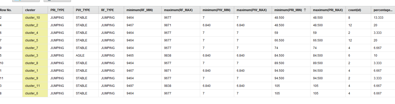

I show an example of what happens. In this case, PW for example should not have variations and should take 6.84 and 7 in the same cluster and not separate it. But this happens because RF should have less weight to disaggregate it less.

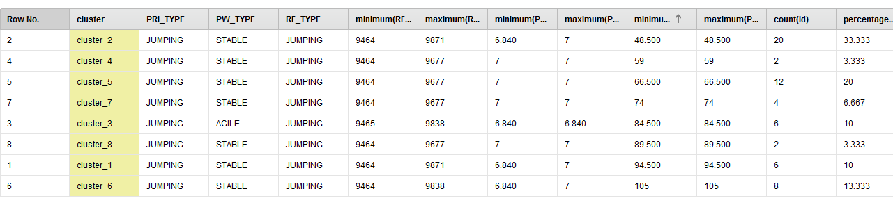

Properly done would be to move the weights of RF, to give less importance to this, and so that it does not create new clusters due to that small variation of RF. In this case, it should take as RF is always between 9464 and 9871, without making new clusters between these values. So I de-weight RF, dividing it now by 1000, and I get this.
