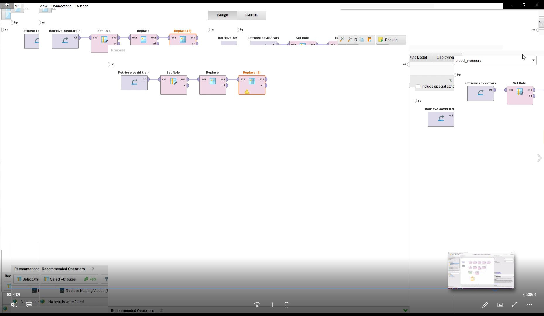

Hey,recently i just got RapidMiner studios for educational purposes.Everything in the interface just scatter around whenever i hover my cursor.Please help me if you know what's wrong.I tried to uninstall and then install again but it won't works.
I can't share a url's of the video but i got the screenshot to get what's i mean.Please Help

Hi,
Usually there are 2 causes for this:- You have a broken extension installed, that causes trouble. Did you install any extensions from the Marketplace?
- Your graphics card driver is not working properly or you have some very weird graphics chip.
https://stackoverflow.com/a/27768329/2333093
A more techy solution: https://stackoverflow.com/a/26610279/2333093
Both are just fixes for symptons, they do not fix the actual cause, though.

Hi @Dylan_Juan ,could you help us here and give some specifications on your operation system and hardware you're trying to run RapidMiner?Best,
David0 -
Hi @David_A ,thanks for the reply
Currently i'm using Windows 10 Pro OS. I've got amd 3600 processor and 16gb of ram and nvida cards.Is there any problem running RapidMiner on AMD based platform *I think i've already turned on the AMD-Virtualization on the bios recently.
If there's any solution I would love to know.

Hi,
Regards,
Marco2 -
Hi Marco,
Yes, i thinks it's a weird graphic cards chips;Tried to update my driver and sets all the settings to default.Then run the RapidMiner as an administrator
*Runs as administator and turns out it's working properly and i'm not see any graphics issue anymore.Idk what's wrong
Thanks David and Marco.You guys are very helpful.
Sincerly,Dylan
