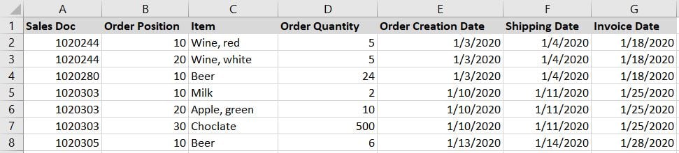

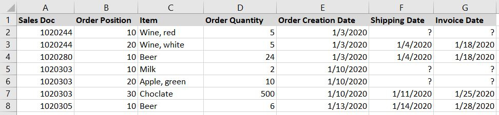

In my dataset (~23000 records) some values (dates) are missing. The dataset looks like in the screenshot below:
Every row is a position on a particular customer order. Every order has a unique Number (column A). Shipping and Invoice Date are only displayed on the last position of the order.
How can i fill the missing values with the matching data (based on "Sales Doc")? The filled dataset should look like this:

Hi @sebasvog you can do it by using the replace missing values (Series) operator since you are working with dates.Configure the replace type date time to the option next value as shown in my example.
You could also create a data set with the Order and the dates you are interested and then join them with the original data set- Select Attributes: Order and Dates
- Filter Examples: Not missing on the Dates you want
- Remove Duplicates: just in case you have some
- Join: Join by Order Id with the previous DataSet
