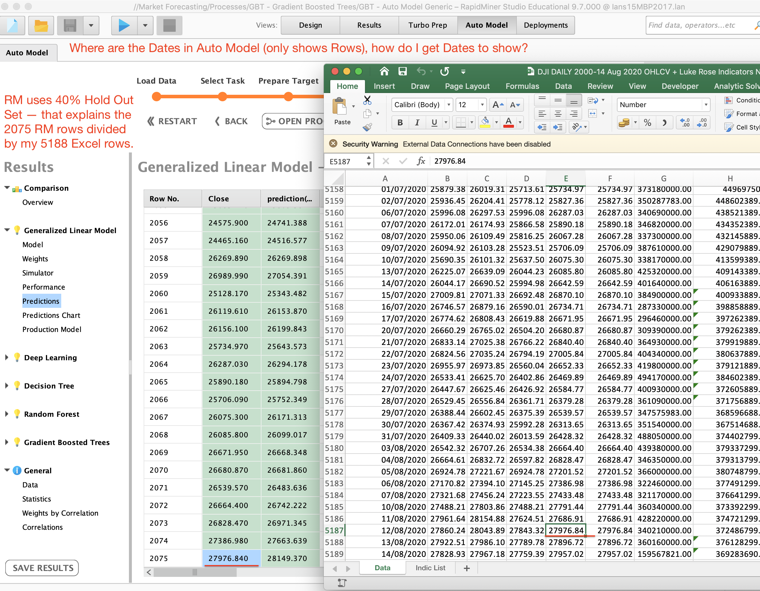

Do the RM Closing prices not consequentially match the Excel file Column E closing prices because of this disjoint subset testing and is that why there are no dates provided in RM Auto Model results? (The closing price in Excel in row 5186 is 27686, not 27386 as in row 2074 in RM).

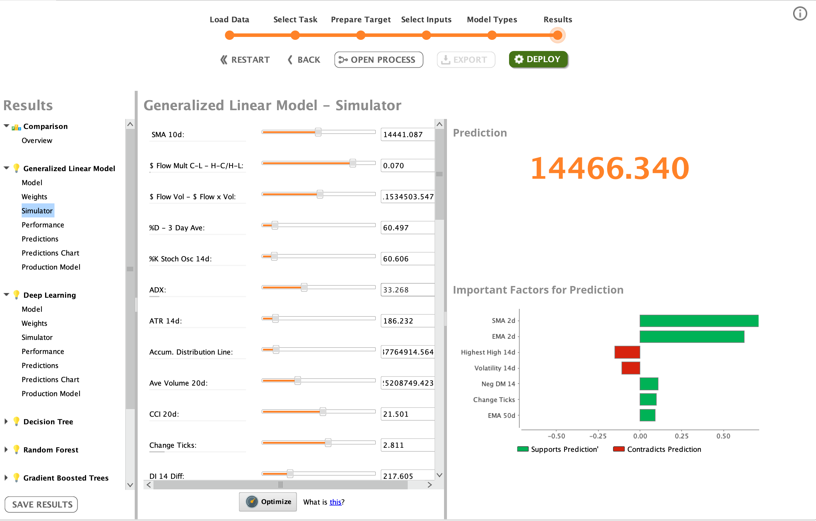

Lastly why is the Simulator prediction price so far from the actual current closing price? The Dow Jones is currently at 27778, how do I interpret this 14466 result?

    I do not know the exact nature of your project so my suggestions may be misplaced. However, my experience of working with stock market data indicates that it is very difficult to get good results (if it were simple there would be lots of very rich people walking around and the market would readjust). Getting 0.3% relative error most likely means you are leaking future into your predictors. For example, if you use adjusted closing price to predict closing price, or even if you include some technical features as predictors when they are calculated over the period of time which catches some of the future, or you if include the total market closing figures when you predict an individual stock, etc. So you need to be ware of leaking future, validation, testing data into your training. This is in particular very easy to do when working with time series. I've noted that you used moving averages as predictors, perhaps they were calculated taking some days from the past and some days from the future? Is so, here we have an explanation for your tiny 0.3% relative error!
