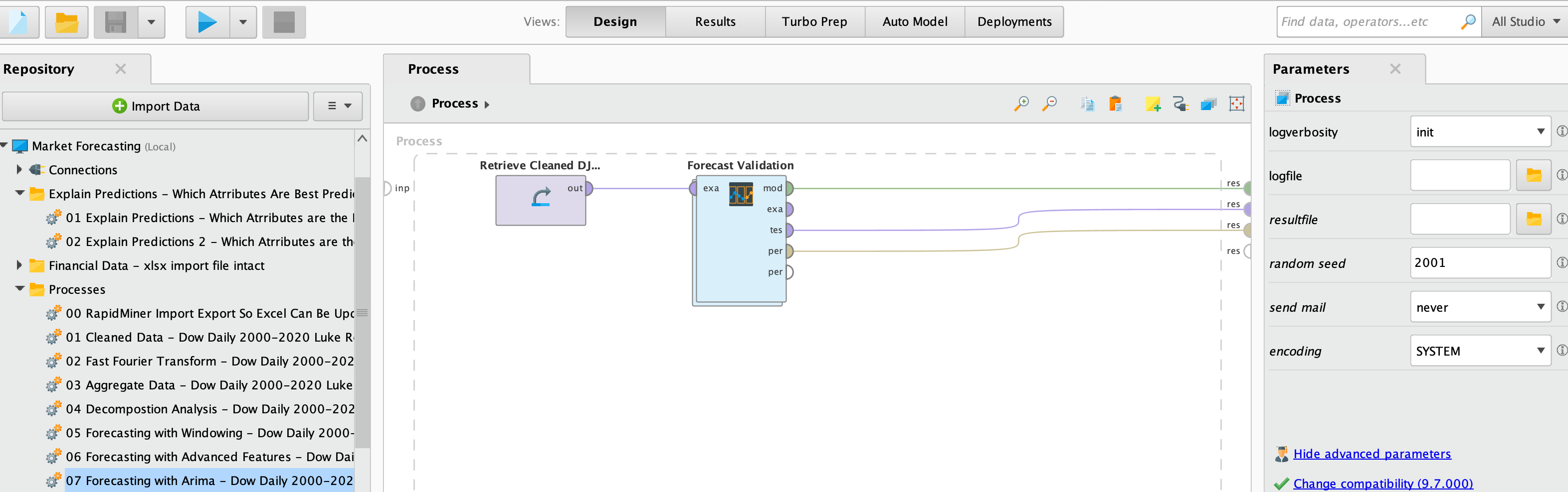

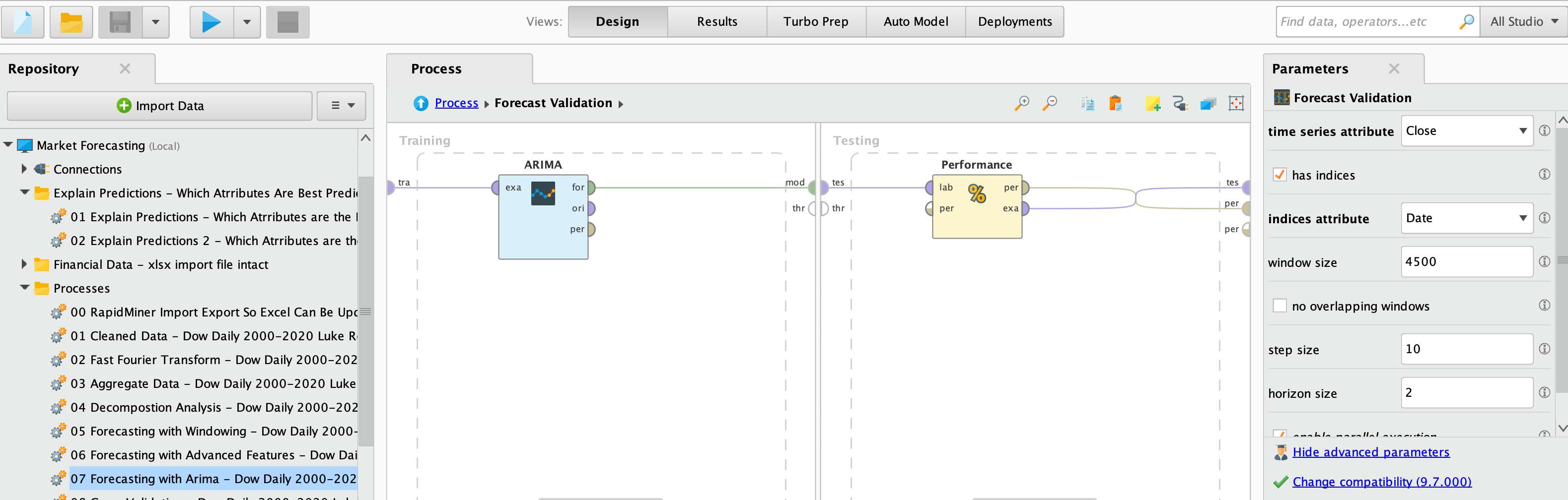

I’m really hoping someone can explain what’s what when using ARIMA for Time Series Predictions!?
When I’m using ARIMA and this set up:
Pls see images.
I used a huge window size so I could see what was happening chart wise over the last few months. There’s no zoom in on the charts?
At first I thought I was training on the window size of data and then testing on unseen data (I have 20 years of Dow Jones Open/High/Low/Close plus technical indicators from 2000 to 2020). The reason being is because when I put in a very high window size like 4500 days (approx 18 years of data) I would only see about 2 years of charting results from 2018 to present (which I assumes was the test data) whereas if I had a window size of only 60 days I would see a whole chart of 2000 to 2020.
But... all the relative error figures were very small, like, 1 or 2%, — which is far too good to be true, right? I assume that is because I am training on one subset of data and testing on the same data (as it rolls along using my  window size and step value settings)?
The questions I have are:
1) How do I make ARIMA test on two different data sets? One seen and one unseen and untrained? With the Cross Validation operator? And if that is the operator I need, how do I ensure ARIMA trains of specific date ranges so I can make it include calm, low volatility periods and also highly volatile periods, like during Covid19?
2) Make ARIMA test on untrained data?
3) I want the training period to be unanchored and cover the the first 75% of the dataset (2000 to 2015)?
and lastly,
4) How do I get ARIMA to predict the next 2 (or 5, or 10) days ahead of the last date or row of data I have in Excel — which will be 3rd August — when I update my Excel with Yahoo finance data tomorrow night. I.e., so ARIMA will be predicting the closing prices for the 4th and 5th Aug and beyond?
I’ve tried many window size combinations but the low relative errors must be due to the point I raised about not being tested on unseen data.
Even using ARIMA with a small window size of 10 days it doesn’t make a predictions into the future.
I’m hoping those that are interested in Financial Time Series forecasting will understand these issues!
Thanks very much in advance,

    i think the operator you are Missing is the Apply Forecast operator. it takes an ARIMA model and forecasts n-points ahead.
    Also keep in mind that the whole validation is used to determine ther performance of the model. You do this do get the correct settings for ARIMA.
    Unlike other ML algorithms you need to "retrain" ARIMA on a new data set if you want to forecast.

    Training your data set on a training set and testing the model on an unseen test set is called validation in general. This is true for "normal" machine learning applications as well as for time series problems. There are some difference, one important one is how the training and test sets are set up. In a "normal" machine learning use case, you use most of the time Cross Validation, for a time series problem you want to use Sliding Window Validation. Later is achieved by the Forecast Validation operator.
    So your initial setup was already correct for the validation (testing the performance of your model on unseen data). Concerning your questions:
    1) The Forecast Validation operator directly trains a Forecast Model (in your case ARIMA) in the 'Training' subprocess (the left part of the inner process). This Forecast Model is then used to predict the test window in the 'Testing' subprocess and a performance measure is calculated (in your case by the Performance operator). The important output of the Forecast Validation operator is the evaluated performance of your model and the final model, which is trained on the whole input data.
    2) see 1), the Forecast Validation operator does this automatically
    3) Set the window size to 75 % of your input data. For now, window sizes can only be configured in number of examples
    4) Use the final model of the Forecast Validation operator (the top output port) and connect it to an Apply Forecast operator outside of the Forecast Validation operator. Be aware that you cleary have not connected the Apply Forecast operator in the screenshots of your second post. The operator is only placed on top of the line, the line itself is not connected
    Hopes this helps,
    Best regards,
    Fabian
    PS.: I would recommend to go through the in-Product tutorials (click on the 'Learn' tab in the Welcome panel) to get familiar with concepts of RapidMiner and data science. Though it is not exactly directed to time series, it helps getting familiar with the product
    PPS.: When you try to figure out how operators work, you can also check out the tutorial processes at the end of the help of the operators
