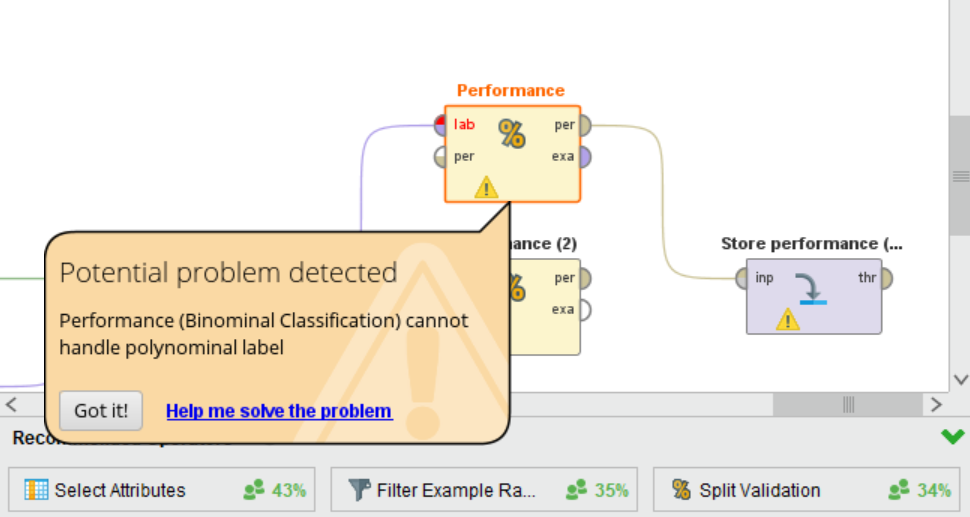

Dear all,
I am getting an error when I connect the performance matrix (binomial) to the model.
I need to calculate F_score as my datasets is imbalance..
Will be truly appreciated if anyone of you faced this issue before or can suggest me the way out here.
thanks a lot in advance,
regards,
Heikoe
Best Answer
Answers
  • Telcontar120
    Telcontar120 New Altair Community Member
    This error is telling you that your label is polynominal (meaning it has many potential values) and not binominal (meaning it has exactly two values).  So you need to make sure you are using a compatible label for this performance operator.
  • jacobcybulski
    jacobcybulski New Altair Community Member
    You can also use a normal classification performance and measure Kappa, which also better copes with imbalanced class distribution. However, any model trained on an imbalanced label classes may end up biased towards the majority class, so performance measurement may not fix your problems. Instead you could try balancing your classes before model training, e. g. using SMOTE operator, and then apply the resulting model to the test set which has the original class distribution (to get a realistic idea on the model performance). Also always check the whole confusion matrix rather than a single value performance measure.
