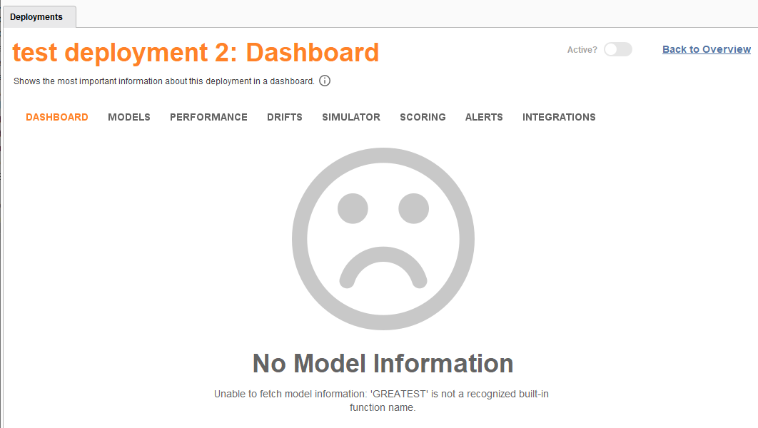

I tried to deploy a custom model in Model Ops on a server that was recently updated to version 9.6. I created a deployment, and then tried to add a model to the deployment. After a few minutes, I get this error message (same error if I switch to the other tabs):
'GREATEST' is not a recognized built-in function name
"GREATEST" is not a word used in anything we have developed, so I assume it's part of the internal Model Ops code.
I tried search the files generated under the repository folder associated to Model Ops, but did not find anything there.
Also, I was previously able to deploy the same model to a local repository (RapidMiner Studio)
I also get the same error if I try to deploy a model trained by AutoModel, from the sample dataset //Samples/data/Polynomial
How can I investigate?

    Model Ops is actually somewhat independent of Server which is why it is part of the Studio documentation.  But you are right on the requirements: this is indeed an oversight and should go into the docs asap.  Sorry for the inconvenience.
    Currently there are no plans for additional DB.  But please note that you can use two different systems if you like: one for the Server and a different one for storing the ops data.
