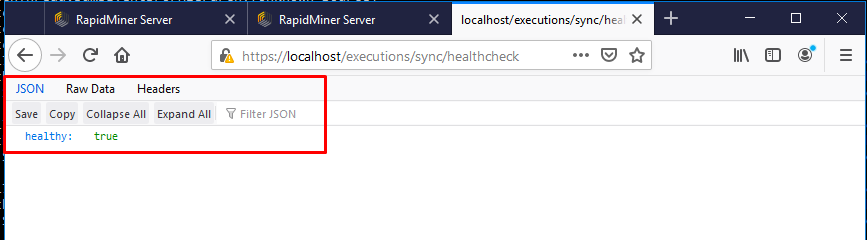

we change the URL for security reasons, but if I browse that URL the output is OK, here is the screenshot:
any idea why keeps showing that error and the Windows Server service does not start up normally?

    During the startup of RM server via windows service or through command line, the RM server tries to start the application as well as the default job agent. The job agent comes up quickly than the server and receives this error when trying to get the health check status. The PKIX path building failed is caused when there is a certificate issue, where the valid certificate is not present in the keystore.
