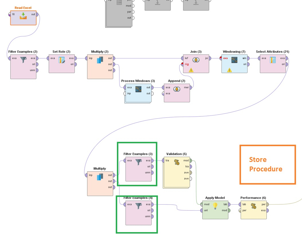

I've attached a process and excel data file. The process looks like this:
Inside those green boxes are two dates and assume the nonexistent Store procedure has a file name in it.
I need to accomplish a few things:
  1. I need to find a way to iterate over dates in the green boxes. (E.G. say I had 4 years of timeseries data... How could I automate the process of training the model on 24 months, applying the resulting model to one week for testing, advance one week, train on the next 24 months and then test on the next week, rinse and repeat?)
  2. What is the best way to store Apply Model output (i.e. predictions with confidences, etc.) and performance metrics (confusion matrix-type stuff) for each iteration such that one can go back and look at them all in aggregate. (E.G. How could I *cumulatively* compare the performance of 24mo training periods/test on one week for a year vs 36 mos or 18mo training periods?)
  3. I suspect there is a better way to cobble together a year's worth of weekly output than spewing out 52 excel sheets and stitching them together by hand... any suggestions?
Any sample processes would be most appreciated! Actual examples are most helpful.

    I converted the date to numerical (via Date to Numerical operator ..logic :) ) and then I embedded your 2 Filter Examples in 2 Loop operators. I try to iterate to create your training windows and your test windows but the output of the Filter Examples are empty ....
    for an unknown reason..!!
    It seems that there is bug inside the Filter Examples operators when condition class = expression is set
                                                       OR
    I missed something ....
    In attached file your modified process (don't worry, due to what I described above, the process raises an error...)
