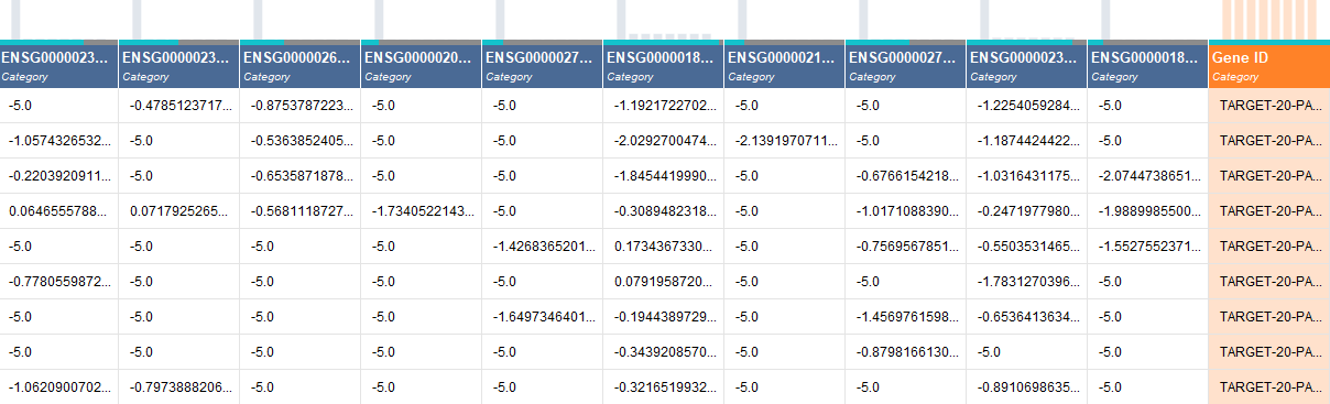

Hi,
I have a set of genetics data with more that 30,000 attributes. All of these attributes are in the categorical(nominal) data type, but I want to change all of them except for one to numerical data type . I couldn't do it by adding the operator "Nominal to Numerical" in the data flow because apparently RapidMiner Studio only supports up to 16384 attributes.
So I'm trying to change the data types from Turbo Prep, but I don't want to manually change the type for each attribute one by one. I'm wondering if there's a way to select all/multiple attributes in Turbo Prep and change everything at once?
Or if there are any other ways?
I attached a screenshot of a sample of my data. Hopefully that helps!
Thanks!

    Hello @gracewei
    I never knew that there was an attribute limitation in RM. Based on your question, I came up with two solutions, one through turbo prep and another through the process window with nominal to numerical.
    1. In turbo prep, you can select all the columns by pressing "ALT" key on the keyboard and click on the first attribute with category type, it will select all the attributes of category type. Then you can go to change the type and change them to number.
    2. I got one idea with nominal to numerical operator and there may be other simple ways as well but you can try this before someone responds with a much easier way. I tried something like splitting the dataset into two parts, as your data has 30000 attributes you can split 15000 each. Then generate ID for both the datasets, this ID will help for joining these attributes back into 30000 dataset. After this, for each 15000 attribute dataset, we apply the nominal to the numerical operator and then join them back with "id" as primary key using join operator.
    I tried this with the polynomial dataset in the samples, below I attached XML process for your understanding, you can copy this XML code into an XML window or RM and click on green tick mark you can see the process. I also provided the process image below with explanation.

    Process image below:
    In the below image, you can see I multiply the dataset so that I can separate attributes. Then I connected it to "Remove attribute Range", here as you have 30000 attributes, the input of the first one is 1 to 15000 and the second one is 15001 to 30000. Be careful while giving these numbers as the first and last attribute are removed as well, do it similarly. Then, I "generate ID" for both of them and converted the attributes from real to integer (based on the sample data), you can use nominal to numerical, then join them based on ID column.
    Hope this helps, as I tried this on 5 attribute dataset it worked, try with your dataset and inform if it helps.
