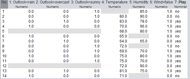

In WEKA, MLP classifier automatically ignore the missing value, but i don't know how it works.
I've read this
http://weka.8497.n7.nabble.com/How-does-MultilayerPerceptron-classifier-handle-the-missing-value-tt44918.html , it says "missing
values are assumed to be 0 in MultilayerPerceptron", so does that mean if there missing values, it will be replaced by 0 value ?
but when I replace missing values with 0 value, the result instead give reduced accuracy in WEKA.
here my practice:
I have dataset that preprocessed by NominalToBinary filter:
then I use MLP classifier, the WEKA give me 64.2857 % accuracy:

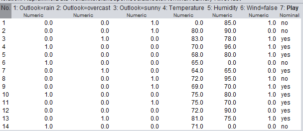

then I replaced missing values with 0 value:
I do MLP classifier again, then WEKA give me 57.1429 % accuracy, lower accuracy than the dataset with missing value:
