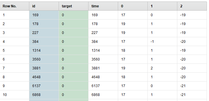

Hi all,
I'm using the new Deep Learning extension (TS to Tensor and Deep Learning (Tensor) operators) in a binary classification project.
The dataset is composed of a collection of 4 examples set. Each example set has 5 attributes (4 regular attributes + target) and 800000 rows.
The target has the same value (0 or 1) for a given example set :
1. When I'm executing the process, the process duration is around 5 hours ! ...( I have a laptop 4 x 2.5 GHz / 16 Go RAM / Windows 10).
My questions are:
  • Is it the normal expected time ?
  • If yes, what do you recommend me, knowing that I'm performing just preliminary tests (The whole dataset has in reality 2904 example sets !)
          to have relevant results in an "acceptable" time ?  maybe Cloud (AWS) solutions ?
2. As a workaround I'm using the Sample operator to reduce the number of rows from 800000 -> 1000 and in fine decrease significantly the computation time. But when executed, the process raises some "warnings" in the Log :
"Couldn't update the network in epoch 1"
"Couldn't update the network in epoch 2"
"Couldn't update the network in epoch 3"
 "Couldn't update the network in epoch N"
Can you explain this behaviour ? What I have to do in my proces to avoid that ?
