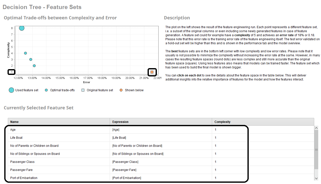

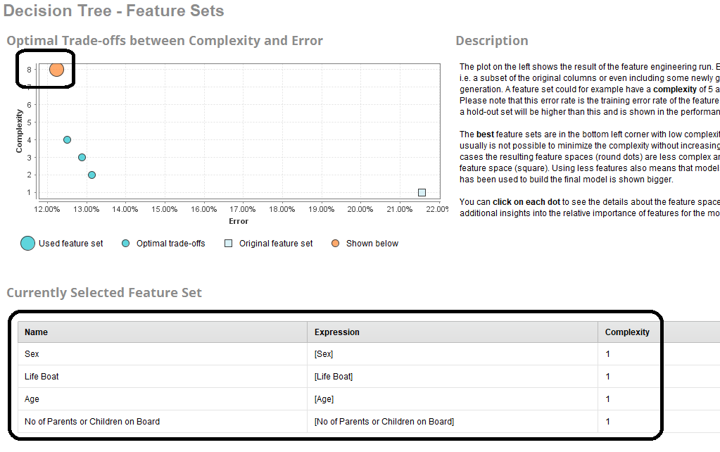

1/ (Little) error of inconsistency between the chart and the table of the Feature Sets in Auto-Model :
To reproduce this error :
- Click on
Auto Model - Select the
Titanic dataset
- Enable the
Decision Tree model (disable all the other models) and of course, enable
AFS (with accurate option)
- Run the model
It seems that it is just a coding error which causes a "shift" between the chart and the table of feature sets.

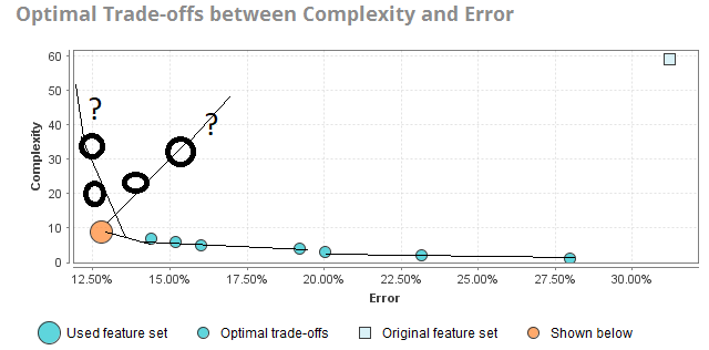

2.1 Plot the optimal Trade-Offs around the optimum :
"... a small diagram is better than a long speech..."
If I good understood, the selected feature set minimize the "distance " between the selected point and the origin of the chart (0,0).
So to visualize that the selected feature sets is effectivly the optimal feature set, it can be a good idea to continue to plot
the optimal Trade Offs . If I'm wrong, thank you to correct me.
