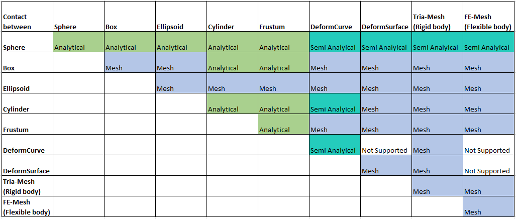

 The current problem is that when the rigid spline and the flexible spline are in contact, the rigid spline cannot generate contact stress, and when the rigid spline and the flexible spline are in contact, the teeth will penetrate.
 I would like to ask everyone how to solve this problem? Please help me to solve the problem again, thank you!
