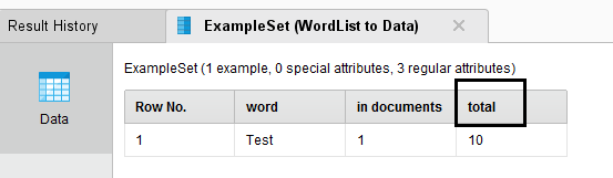

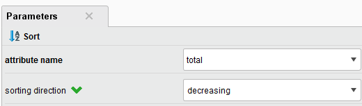

@olgakulesza2,
It's a problem of data propagation : Sometimes it happens....
First try to go to menu Process --> Check Synchronize Meta Data with Real Data.
If attribute name is always empty, type directly the name of your attribute.
In your case, it's a priori the attribute total generated by the WordList to Data operator :
