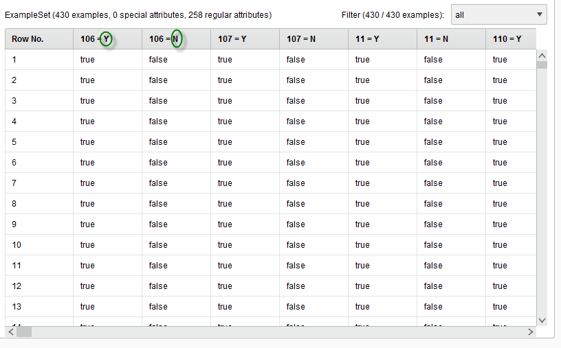

after preparation of data for FP-Growth (binary representation) my example set looks like this:
The next step is transforming the data from nominal to binomial with the help of Nominal to Binomial.

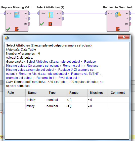

This is the input to Nominal to Binomial:
The operator Nominal to Binomial runs without any error messages - but unfortunately without a result set also..
When ticking the parameter transform binomial*, RapidMiner splits one column into two, which is not what I need for the subsequent FP-Growth operator. *desperate attempt via try-and-error
Any suggestions? ...please..
