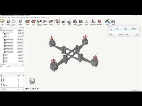

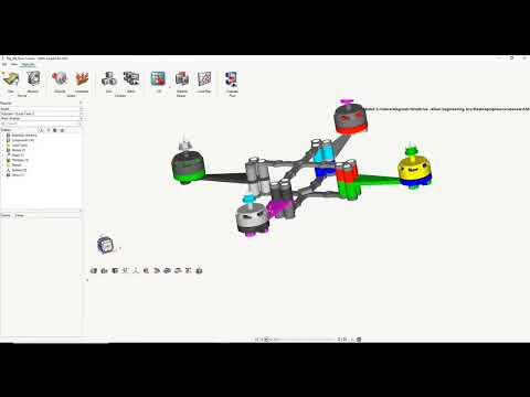

The following diagram and two videos detail how fatigue simulation may be performed on Inspire concepts to give preliminary insight as to the fatigue performance, which can help inform the changes in the beginning phases of design and ultimately help reduce redesign in the later stages of validation. There are two fatigue workflows which may be implemented depending on the solver used within Inspire - Simsolid or OptiStruct.
Video 1: For Inspire (Simsolid) concepts implement Simsolid (Advanced)
https://www.youtube.com/watch?v=hZJfHUWwphI
Video 2: For Inspire (OptiStruct) concepts implement HyperLife
