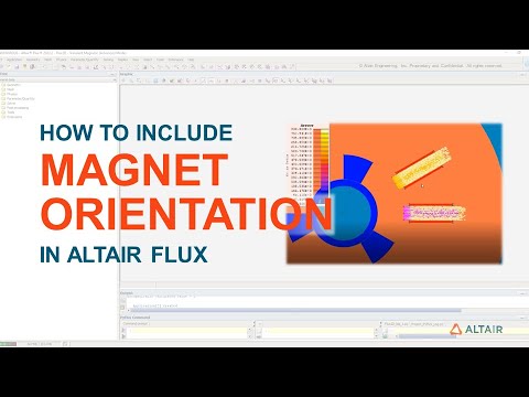

In Flux, two types of magnet orientation are predefined and easy to set: radial and orthoradial orientation.
On the other hand, if the orientation is in a specific direction, a separate coordinate system should be created for the magnets. Then, the magnetization direction should be assigned within the description of the face or volume regions defining the magnets.
The procedure for assigning the orientation to the magnets in a specific direction is explained in this video.
https://www.youtube.com/watch?v=j6jRoi-qNOk
