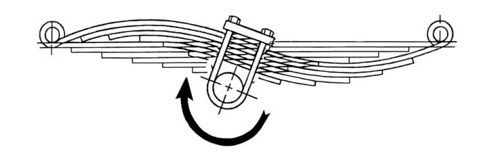

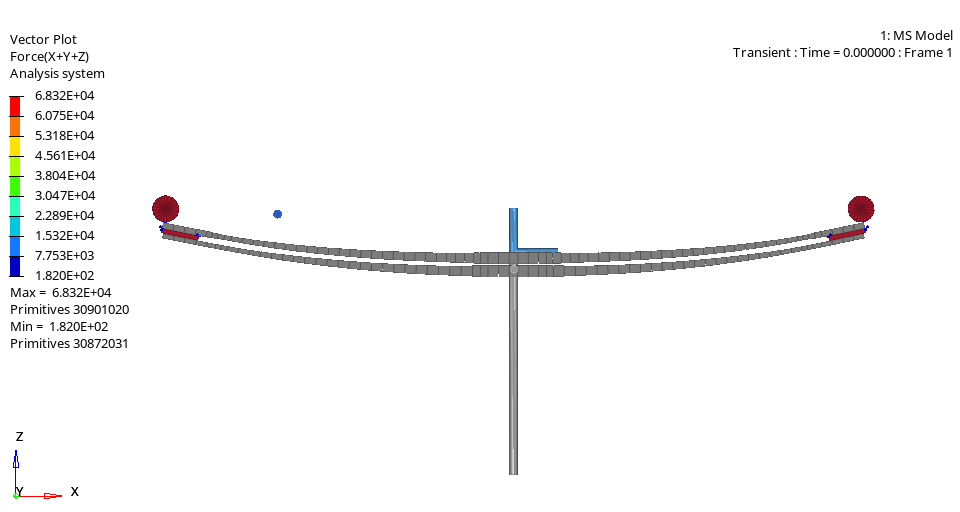

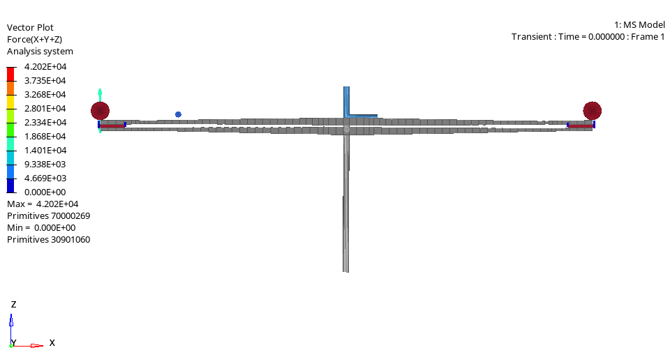

To determine the location of the Wind-Up Center, a torque is created by applying a force to the bottom of a jack. Once at rest, a measurement is taken from the WUC to the upper leaf surface.

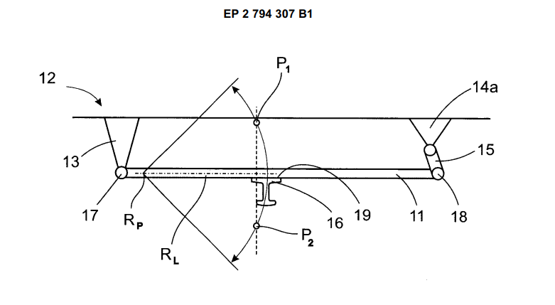

To determine the location of the Ross Point, the WUC starting (P1) and ending position (P2) is recorded to used to find the arc center or Ross Point:
In addition to the Ross Point, the Ross Line Length and the Ross Line Angle are calculated to gather all of the necessary outputs to this sequential simulation.

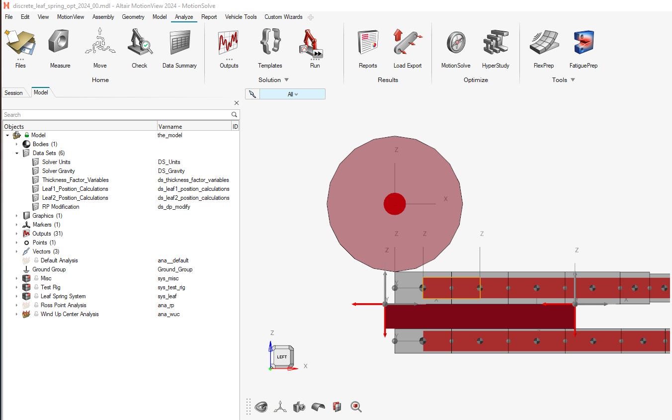

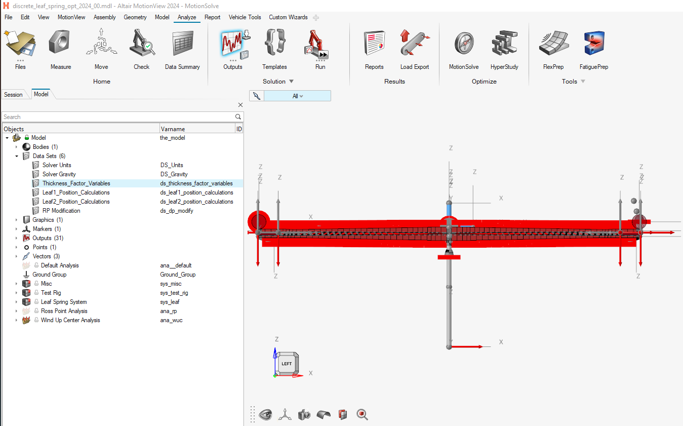

The parent model for this analysis is no ordinary leaf spring model. Although it started out as a model generated from the Leaf Spring Tool, the leaves were discretized and parameterized to allow for automated modification of various thicknesses, nominal loads, and coefficients.
Each discrete part of the leaf spring consists of several bodies connected by a beam element.
With this parameterized and discretized configuration, the entirety of the leaf spring model can be optimized for given targets.

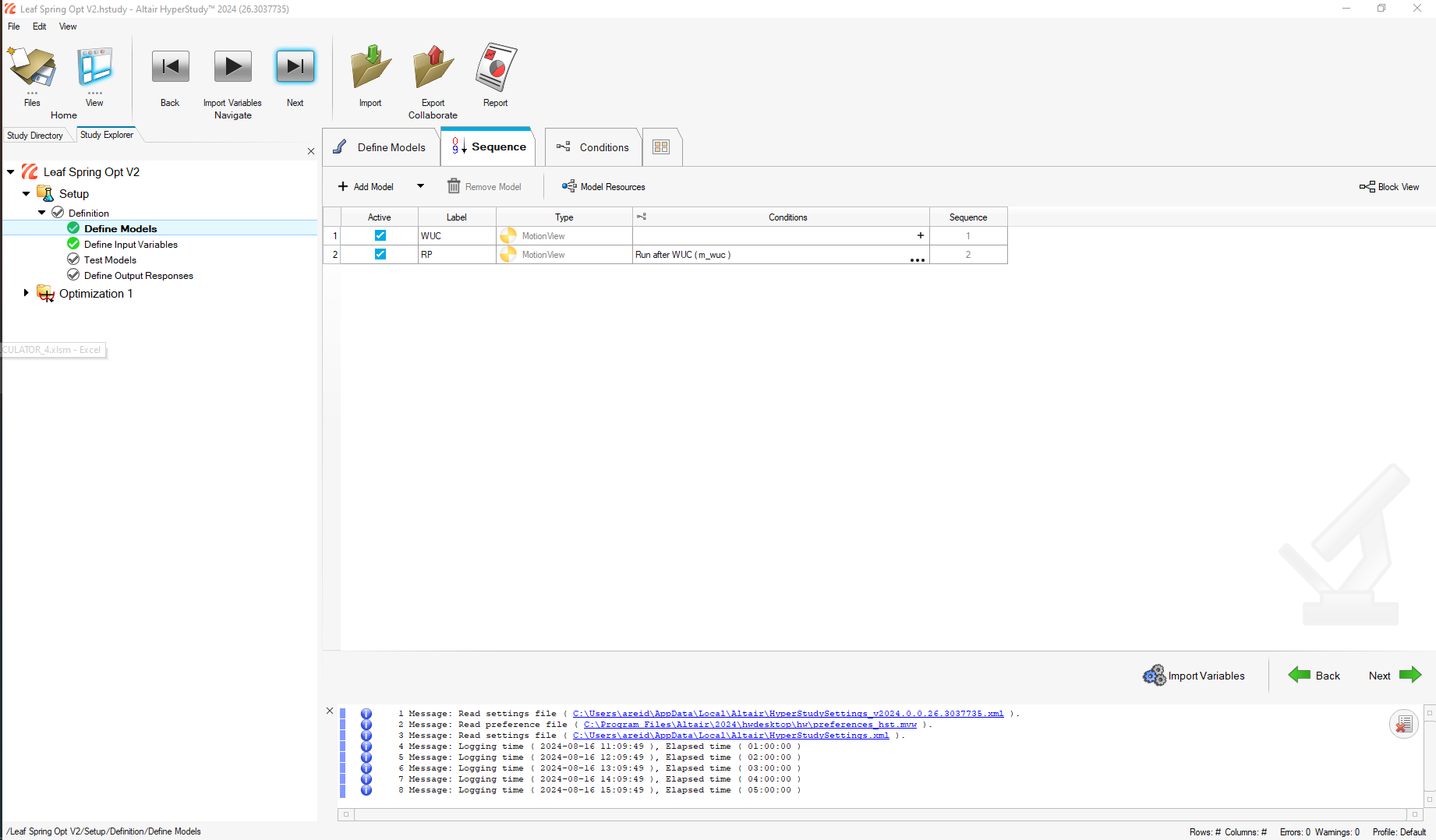

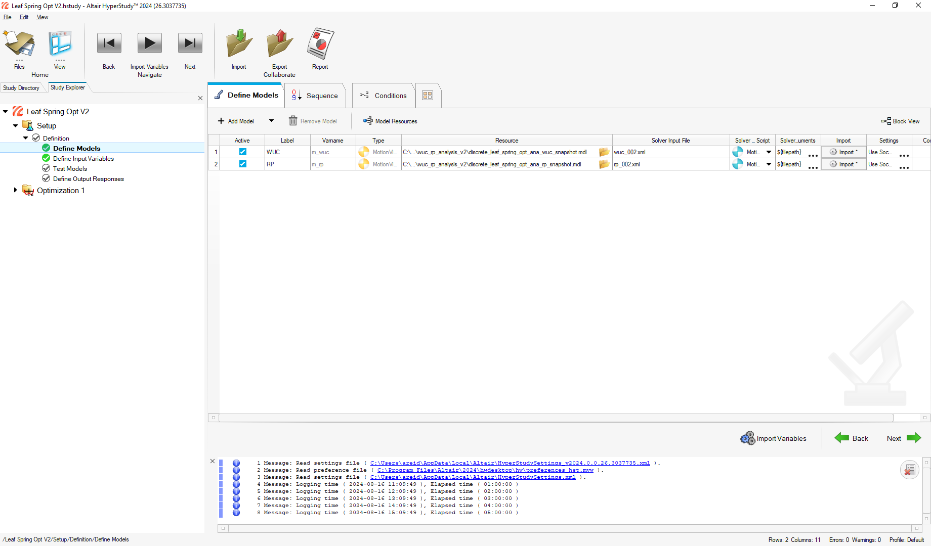

The WUC and RP analyses were originally run from within MotionView to confirm the operation of the simulation and the accuracy of the results. The act of running those simulations produced 2 snapshot MDL files, which are essentially a save point of the MDL prior to producing the MotionSolve solver deck. Both snapshot MDLs are used as model inputs for the HyperStudy setup:
In the sequence tab, it was specified that the RP simulation must come after the WUC simulation:

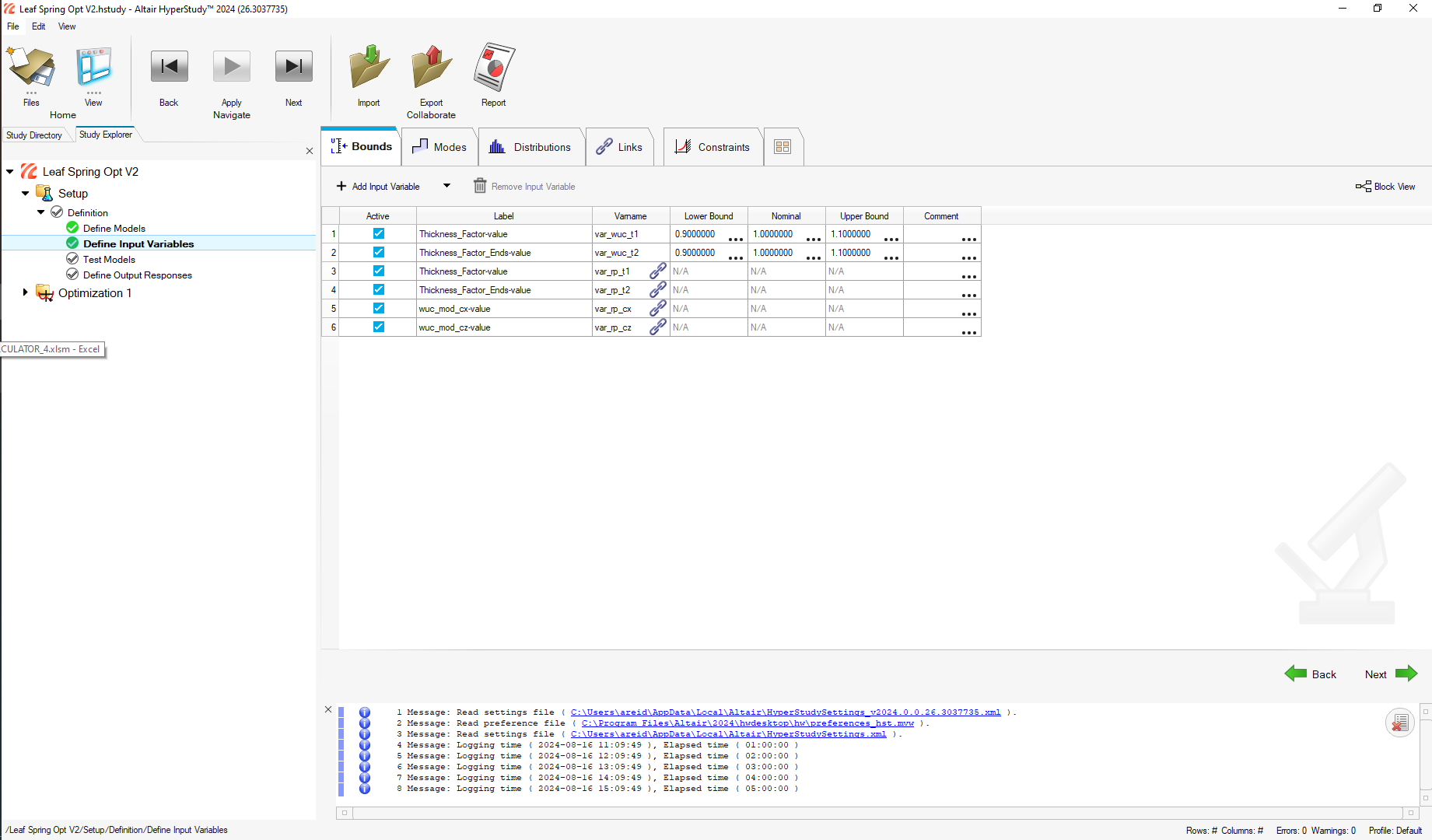

The initial implementation of this sequential optimization only focused on the thickness factors for both leaves. The thickness factors were linked together so each leaf would have the same thickness coefficients, however this could be removed later to explore further options for leaf spring configurations.

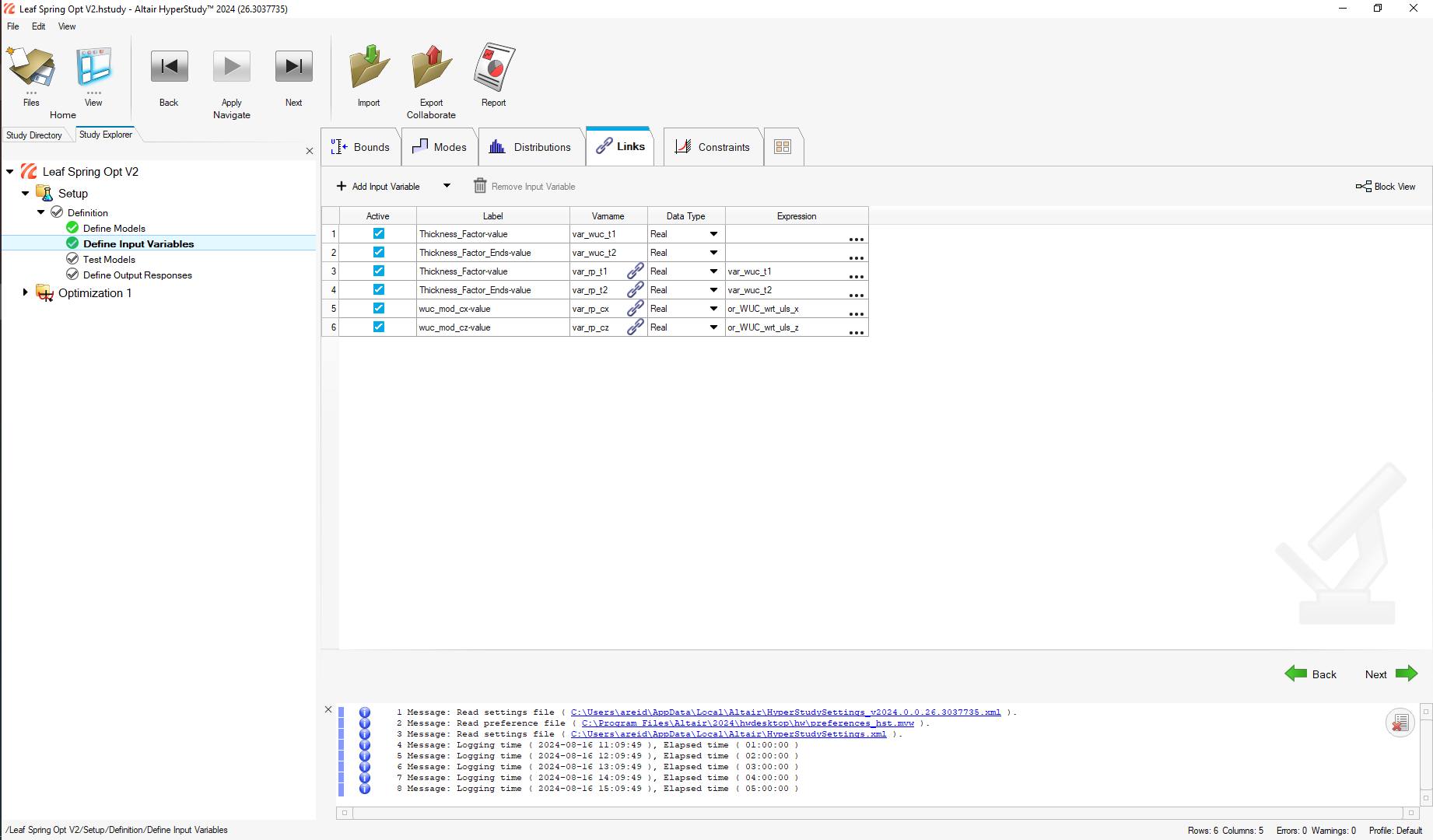

In the links tab, we can also see that the X and Z coordinate for the Wind-Up Center point (shown as wuc_mod_cx-value and uc_mod_cz-value) are linked to an output response. This output response is a measurement of the last position of the Wind-Up Center from the Wind-Up Center event. This promotes the sequence where the WUC simulation is completed first, post processed, and then that output response is used to influence the RP simulation. In order to complete this link, the output response must be defined first, then the link can be established.

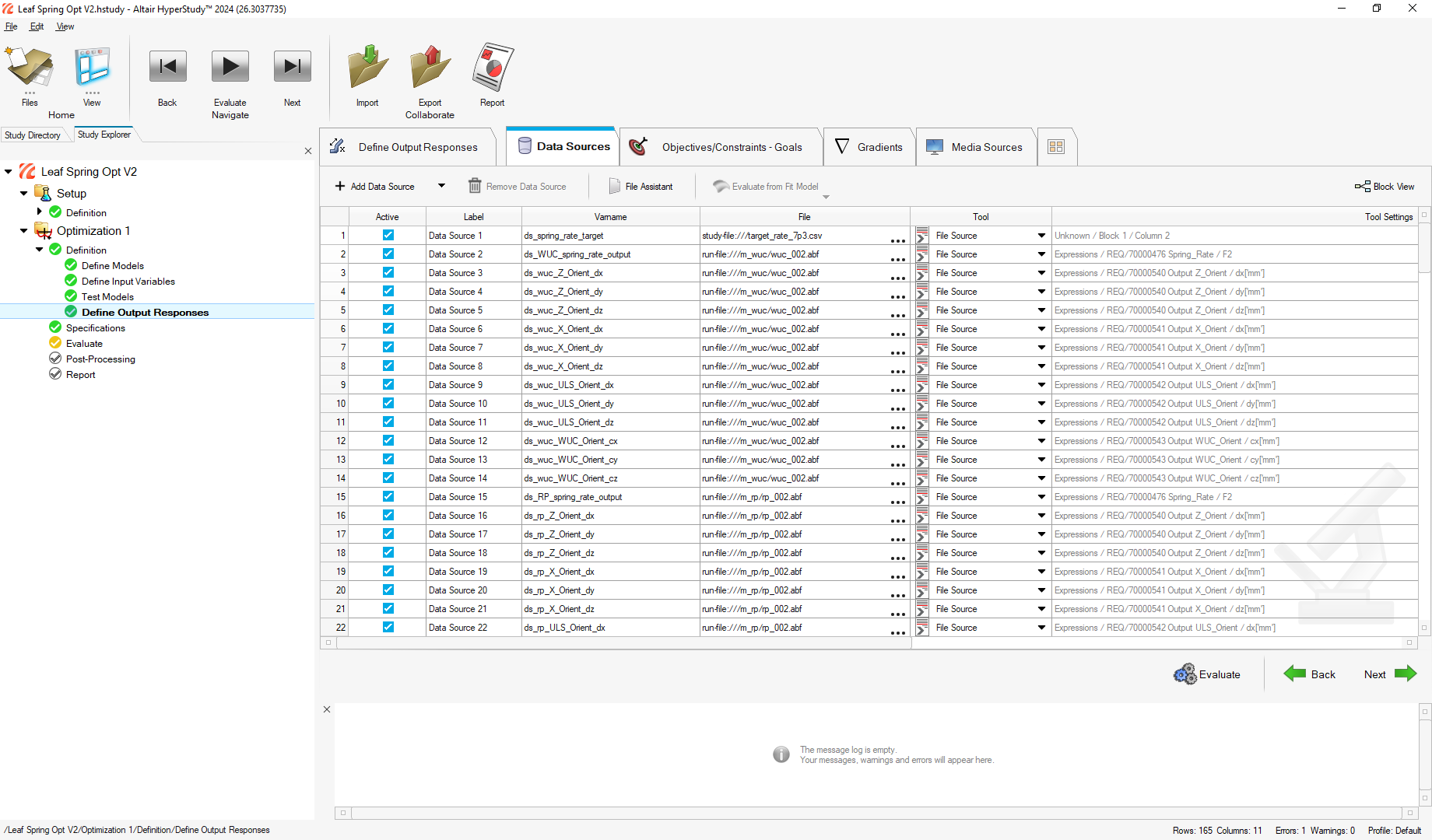

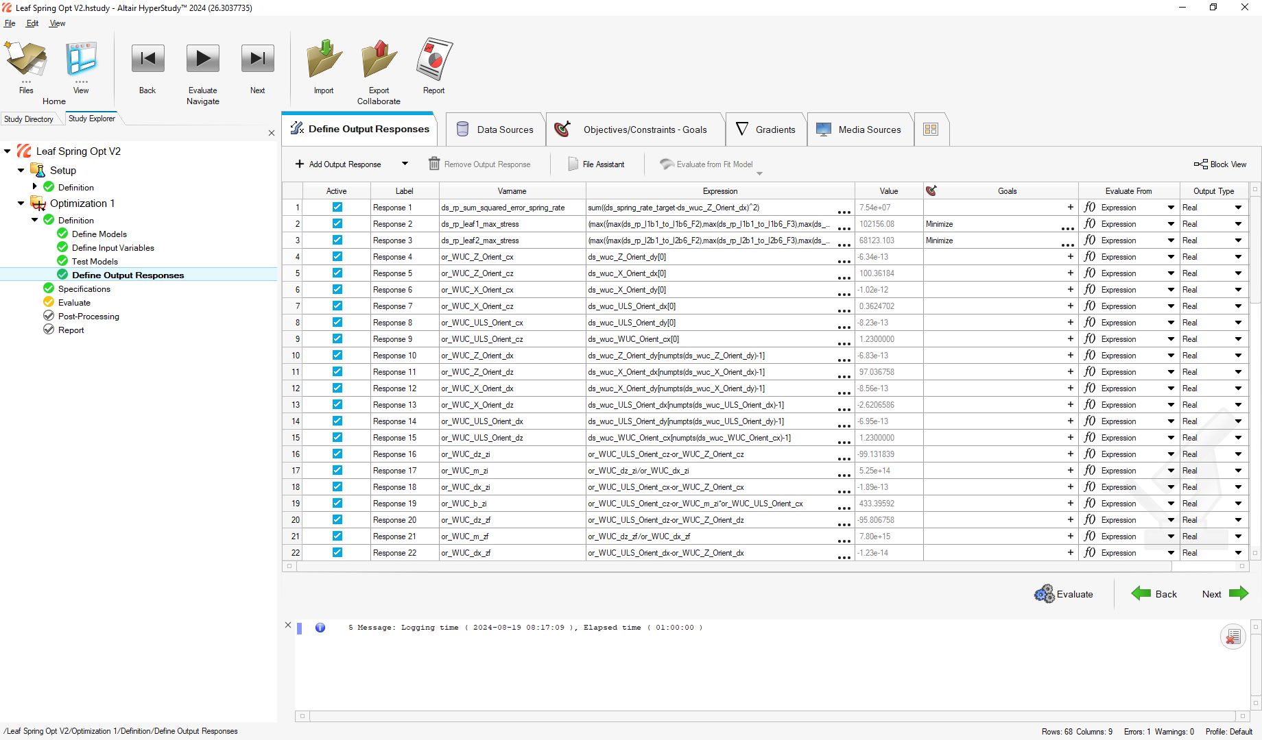

A series of Data Sources must be defined to extract the necessary simulation data for the Output Responses. In this example, a total of 165 data sources are defined to get access to marker locations, target spring rates, and the torques between each discrete leaf spring section for both simulations.
The Data Sources are then referenced in 68 Output Responses to eventually calculate the initial and final positions of markers, maximum stress, spring rate, and arc centers, etc.

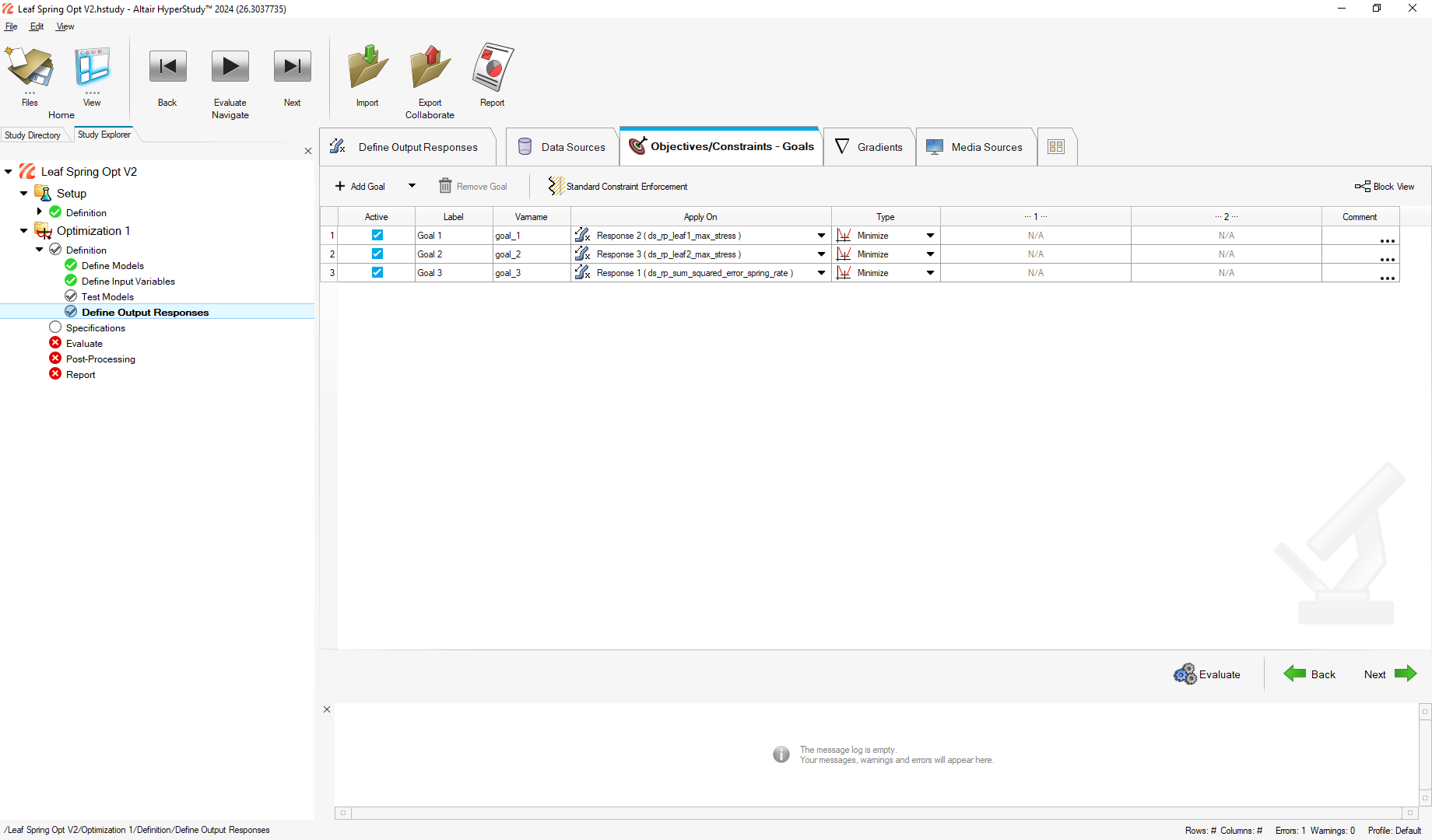

The optimization is then set to minimize 3 objective functions: leaf 1 maximum stress, leaf 2 maximum stress, and the error between the goal spring rate and the current spring rate.
