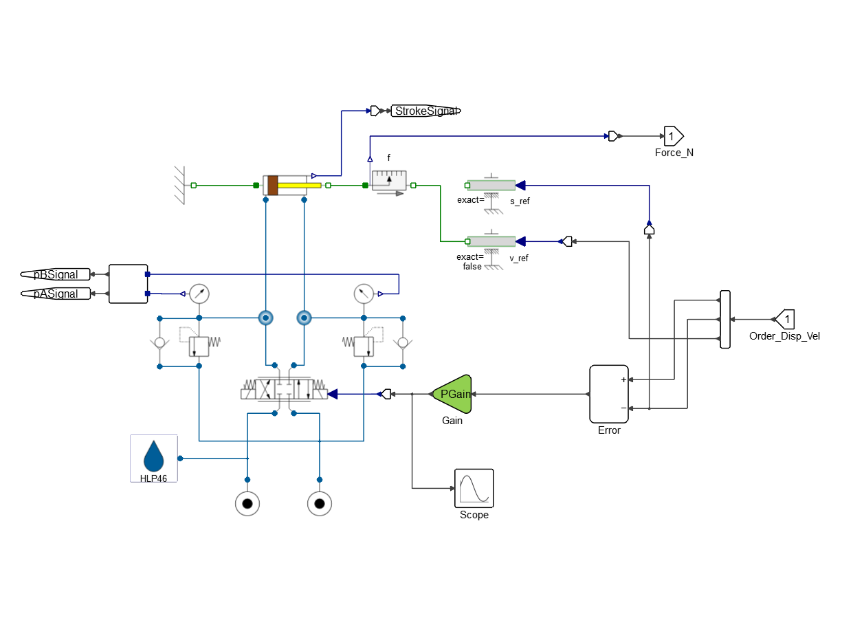

Understanding the Hydraulic Actuators Definition in Twin Activate
To execute the designated task, the wheel loader bucket needs to be moved with the help of a hydraulic actuator. This is done with the help of the Twin Activate 1-D model.
Inputs to the hydraulic controller are the desired position, actual position, and actual velocities. The outputs are the applied hydraulic forces for each actuator.
