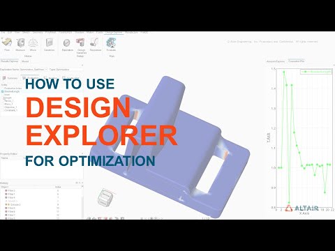

Thankfully, the next day I was able to revisit the problem with Inspire's Design Explorer Optimization. Since I already had the variables set up, it was trivial to run the study. I set bounds for my design variables, a constraint of 1.5 FOS, and a minimize mass objective. The design explorer modified these variables for me automatically to run a bunch of studies and see which one best met my constraints and objective. See the video at the bottom of this blog post for my complete workflow.
Design Variable bounds for my optimization study.
The study finished 20 runs with Multi Execution = 2 at 14.5 minutes on my laptop. For giggles, I also ran this study in SimSolid with 4 passes and adapt to features/thin solids and it finished in 11.5 minutes. I didn't care to do a convergence study between the solvers but both runs pointed to maxing out the Inset and Height. SimSolid got higher stresses in the fillet and recommended a slightly bigger BracketLength.
In the Results Explorer browser, I could see the results of all my runs and review the optimal design! This one clearly meets my minimum FOS so I should be able to rest easy. Off to the printer, this design goes!

Video of my Workflow:
[0:40] CAD and Variable Setup
[2:40] Baseline Analysis
[3:50] Design Explorer Setup
[6:30] Reviewing Optimization Results
https://www.youtube.com/watch?v=99Ffwfj6ODY
