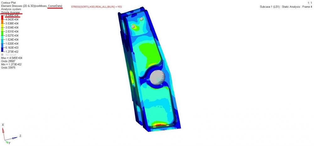

Since optistruct/RADIOSS calculates stress at the element's centroid by default, I supposed that the equivalent command in the .fem input file for optistruct would be: STRESS(SORT1,H3D,REAL,ALL,BILIN) = YES (I have replaced 'VONMISES' with 'ALL' to have all stresses in my output) and performed two examples of simple static analyses: one with shell elements: the well known hole in plate and another with a bracket meshed with solid elements (4 noded tetras). In both cases the results from MSC NASTRAN and Optistruct were identical, as long as in Hyperview I activated the option 'use corner data' (participation of element to the node). Without 'corner data' activation the difference in VM stress between NASTRAN and Optistruct for the hole in plate problem was 175 MPa (NASTRAN) to 157 MPa (Optistruct).
