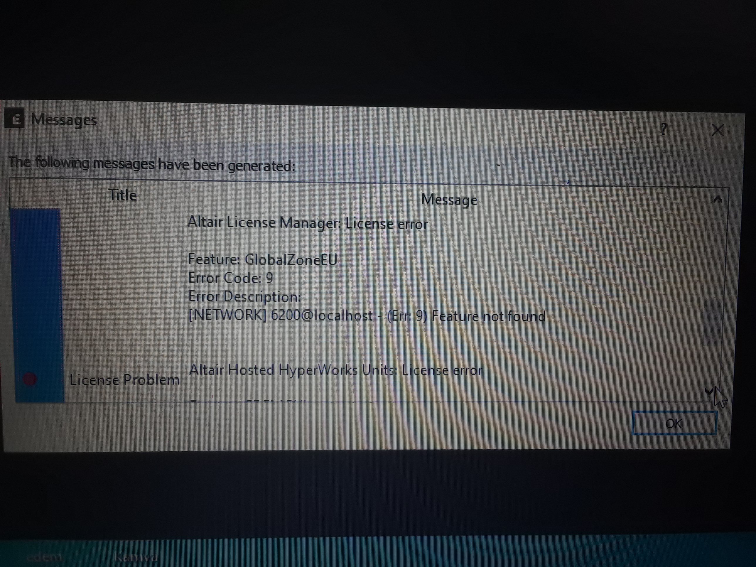

Hello Rahul. I am getting error code 1 and error code 9 as show on the pictures below. Error code 9 says feature not found and error code 1 says unable to check out 21000 EDEMGUI licence(s). Can you please help as soon as possible. Kind regards
Hello Patience,
according to the error message you shared the application is failing while trying to reach a Server license at 6200@localhost and/or failing to reach a Hosted license.
The first step will be identifying which is the correct license type that you have, it could be either Server, Standalone or Hosted.
- If your license file is a Server license: possibly the host is not your local host (your own machine) so you need to identify the correct host and place it in the environment variable:
ALTAIR_LICENSE_PATH=6200@name_of_your_server
- If your license is Standalone: You will need to add the filepath with name and extension pointing to your standalone license file in the environment variable. For example:
ALTAIR_LICENSE_PATH=C:\Program Files\Altair\altair_lic.dat
- If your license is Hosted: You will need to authorize your machine for Hosted license usage. For this you can choose either entering your Altair One account credentials in the License Setup Window of a HyperWorks (new gui), Inspire, SimLab, among others. Or generating an authorization token from your Altair One account > Profile > View my authorized machines > Generate Auth code; and entering this token into the license utility of the application you are trying to use.
I hope this helps you to troubleshoot the issue.
