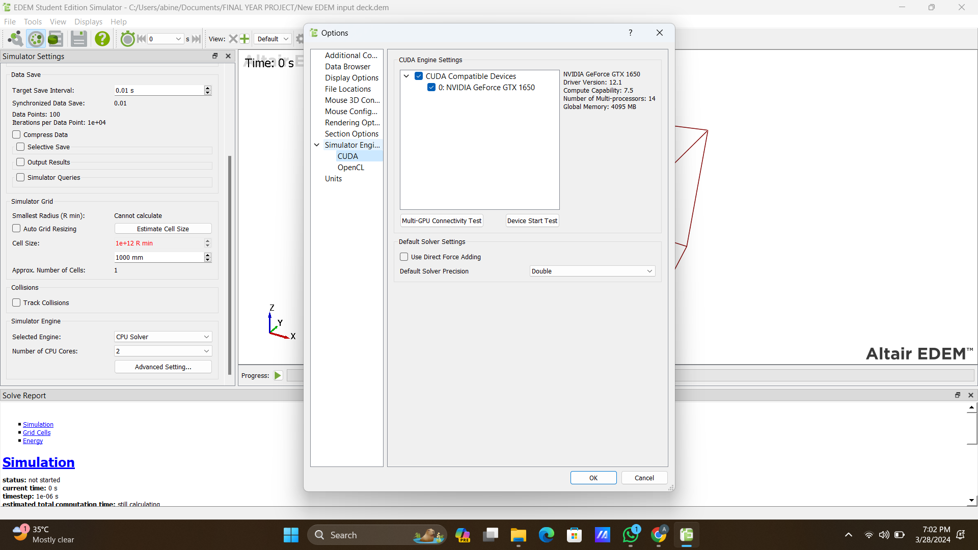

Hi,
From the attachments, You can see that I have selected CUDA Engine, but in the simulator tab the GPU solver is not there to be selected in the selected engine box. Can you tell me how to resolve this problem?
Hi Abinesh
Please update your GPU driver, and it must resolve the issue for you.
Hope this helps.
Thanks,Jerrin Job
I have updated my driver. But still there is no GPU Solver in the Selected Engine box. I have a student version EDEM 2022.3 version. Is this is because of student Version?
Thank you for that additional information.
Student version can use 2 CPU cores (maximum) and no GPU. Other limitations are the 10000 particle limit, and disabled functionality on heat transfer, field data import and coupling to other solvers.
