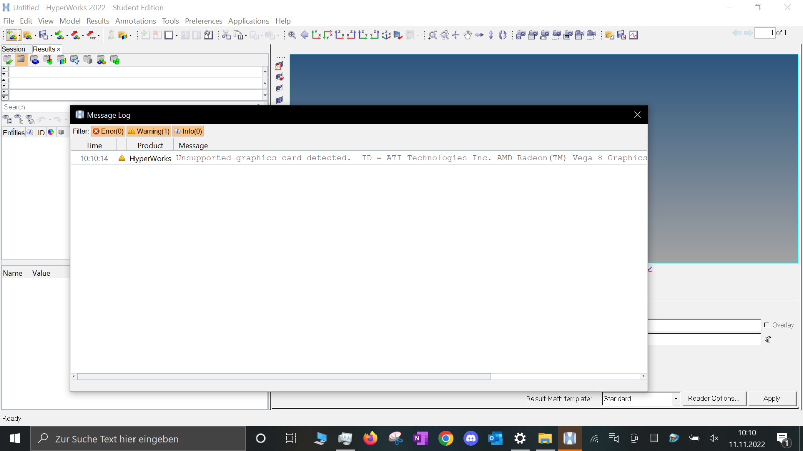

hw.exe opens, warning: "Unsupported graphics card detected. ID=ATI Technologies Inc. AMD Radeon (TM) Vega 8 Graphics. This warning will only appear once..." , only has HyperView options

opening HyperWorksDesktop with HyperWorks: File --> New --> HyperWorksDesktop: hwx.exe Invoke Error hwx has been calles without the -plugin argument. The ribbon may be blank
after closing the error: Error Hyperworks has encountered an error and must now exit.
