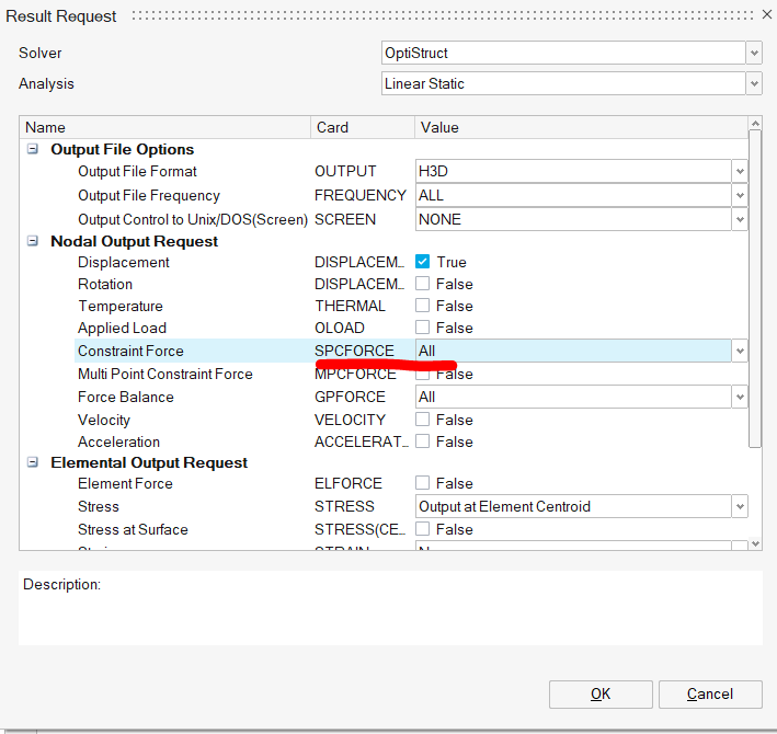

Hello,
Is it possible to read/display/plot the force that is needed to enforce a displacement by a enforced constraint in Simlab?
Thanks,
Jernej

    In SimLab, if you're using OptiStruct, you will need to request the reaction forces, calling SPCFORCE, under the 'Results Request'. nodal request.
