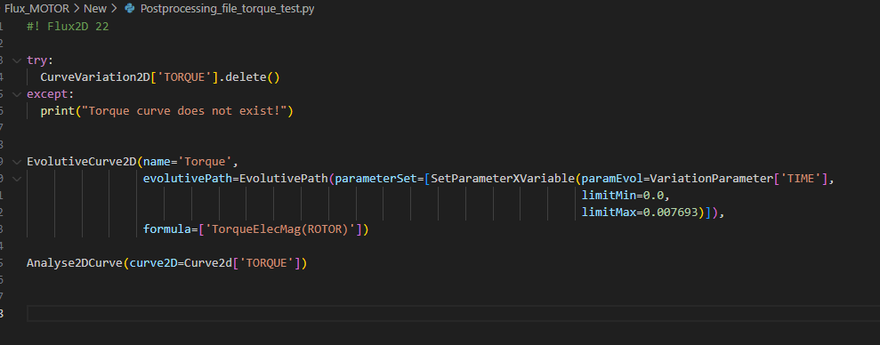

I am trying to export my model from flux to hyperstudy for Torque optimization purposes. I need the rms value of torque. also i have loaded the analyze 2D curve macro so as to get the torque IO params and also created an external python file for post processing ( i created it in VS code software) and added it to the same path as my model. but in hyperstudy, i dont know why i am still getting errors. how is the python script utilized in hyperstudy, i will post the screenshot of the error and what i am experiencing now. please help. i created a ticket but i hav not gotten any response up on till now. can you help me step by step how to solve this problem?
PS- i know how to export from flux to hyperstudy. but the use of the post processing py script from flux and how it integrates in hyperstudy is the problem. and what is PDD file too and why doesn't it exit ? how can i sucessfully extract the model so i can proceed to optimization

    Thank you for using our Forum, this message can happen if the Flux simulation didn't run or if a problem occur when running the python file for the postprocessing so we need to investiguate more to find the reason.
    I see in your message that you create a ticket, have you got a replied with a reference for this ticket, if yes could you share it with me in order to have a look at it.

    The ticket was canceled and I was asked to make my inquiry here in the community that's why I asked here.
    What information regarding my simulation do you need me to provide to help solve this issue? Do you want me to send the flux file ? Or what specific information do you need me to provide

    For a first check, could you check in the working directory in the folder approaches → steup_1-def→ run_00001 → m_1 and share all the file available in this folder exept the .Flu folder?

    these are the files available in the m_1 folder
