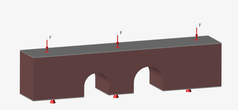

Have you ever looked at a bridge, and wondered what factors determine the ideal support system for such a structure?
Now is your chance to use Altair Inspire to help answer that question.
In this challenge we have a scaled down bridge, for which we want to determine the preliminary structural layout.  The bridge deck must remain intact, but the supporting structure (under, or even over, the deck) can be optimized using topology optimization.
The structure must be able to support its own weight, plus the applied loads in the model.  The goal is to minimize deflections, and eliminate redundant material.  You may use the provided design space, or create your own.  Ensure that the structural layout does not obstruct vehicle movement across, or underneath the bridge.

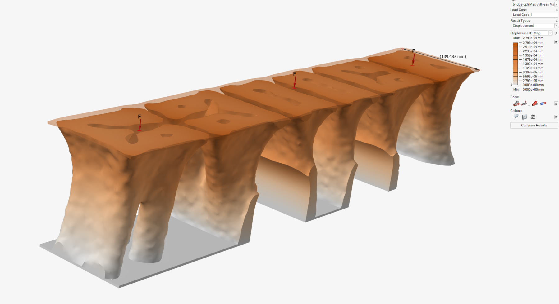

    User: "David Galvis_21599"
    Altair Community Member
    Updated by David Galvis_21599
    Hello!
    I ran a simple optimization and it looks curious, reminds me of trees somehow due to its shape! As objective, it reduced 65% of volume and went from 119kg of steel to 62.8kg. It mantained deflections on ranges of maximum 156nm, which I would think is acceptable. Surely there are better ways to optimize it!
    User: "Matthew_Sauer1"
    Altair Employee
    OP
    Updated by Matthew_Sauer1
    Hello!
    Very nice, David!  Thank you for your submission, we will be reviewing the submissions in the coming days and selecting the winner so please stay tuned!
