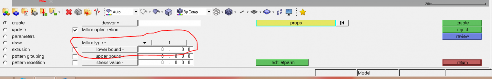

Hi @OptiStruct If you are using 2017+ you can change lattice type using GUI. Goto Topology panel>> Lattice>> change lattice type
