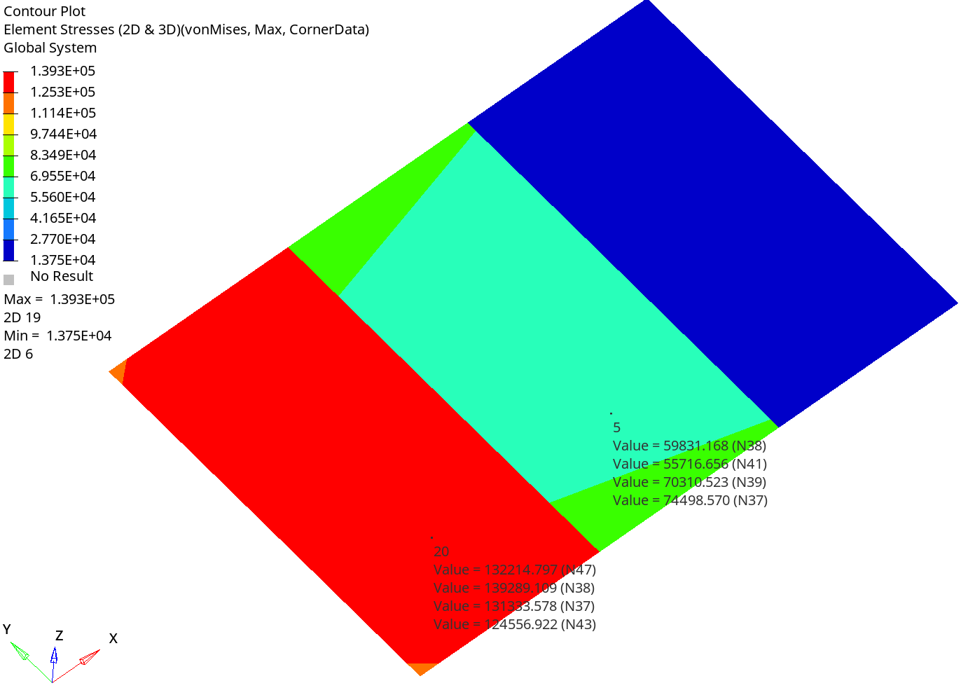

Hi everyone, I need to read and manipulate Corner Stress Data from h3d file in Compose 2022.3. I do not want to ave any average on nodes. From what I try based on discussion "How to Read Corner Stress Data through Compose?" i can only obtain an avaraged output at nodes, it means in case I have 2 different materials or shell thicknesses occurring on the same node I loose the corner data related to the node for each attached element. I'd like to have as for Hyperview, when using corner results switched on and average none, see image below.
It is possible to get those results?
