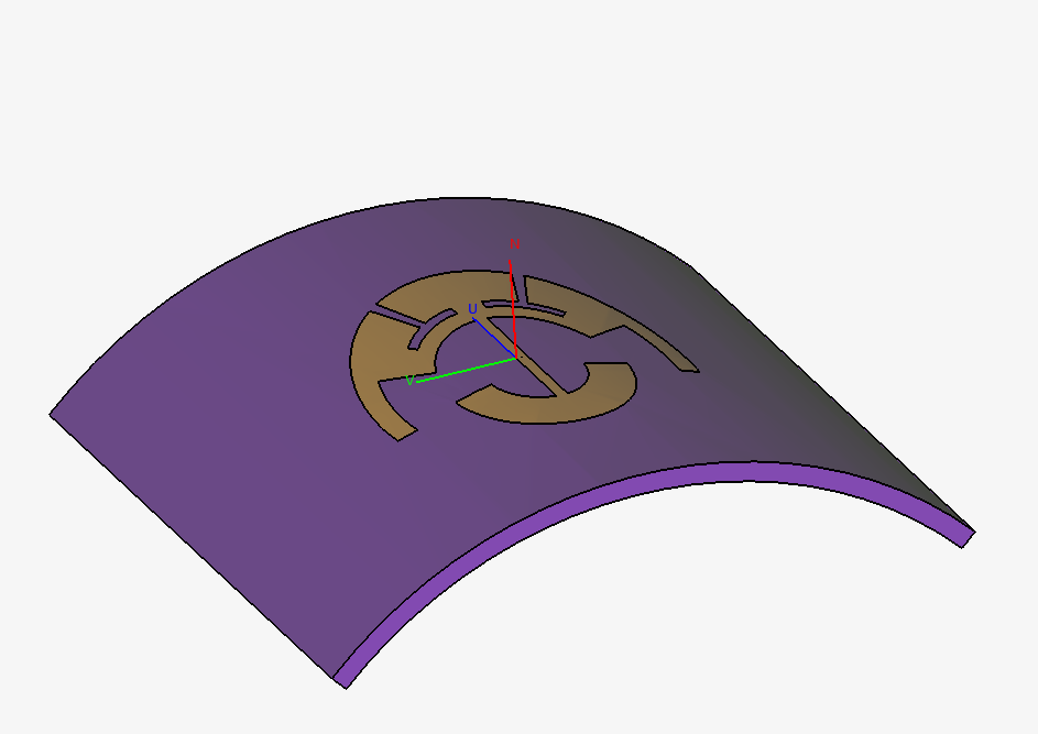

Here in this model, I have two problems
Could anybody kindly fix this wire probe location and air gap?
Hi @sswh2 ,
When trying to project "default_Boss_Extrude4" on the "Split_back1" (cylinder), remove the thickness from "default_Boss_Extrude4", so that a single surface is being projected instead of a volume. This will solve the issue of gap that you see.
To create a wire probe, it is best if you bring the geometry to (0,0,0) co-ordinates so that it is easier to create the wire.
Regards,
Shannon Mistry
@Shannon_Mistry mam thank you so much! However, this file is showing an error. Can you please tell me how to fix it?
