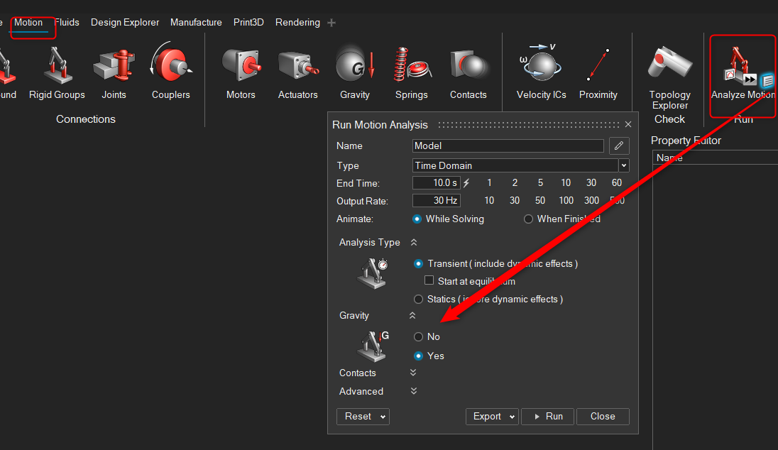

If so is it "always on"? Can you turn Gravity off? Thanks.
Hello @Kennovation, You can turn off the "Gravity" in Inspire from the "Analyze Motion" ribbon, in "Motion Run Settings". Refer the image below.
