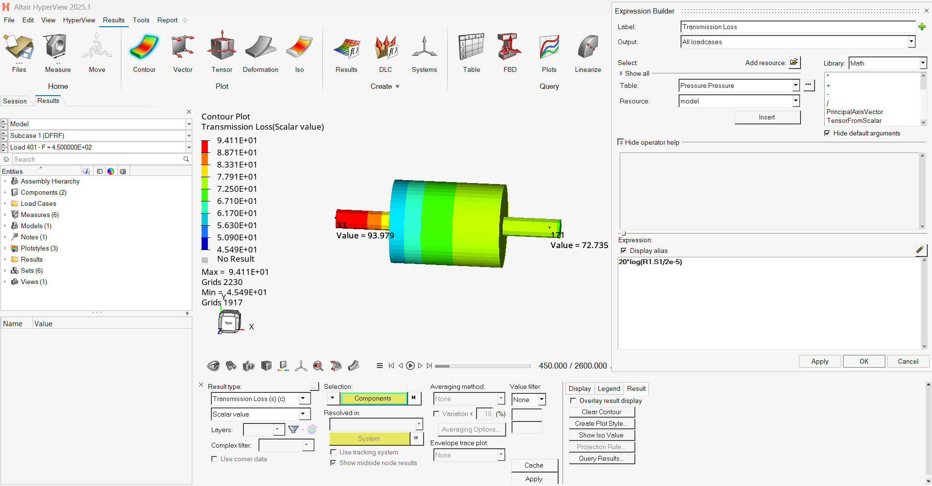

I am working on a transmission loss analysis. In HyperView, I am calculating transmission loss using the expression:
20 * log(R1.S1 / 2e-5)
This gives me a transmission loss of 60 dB at 500 Hz.

HyperView results,
Transmission Loss = 93-72 = 21 dB at 450 Hz

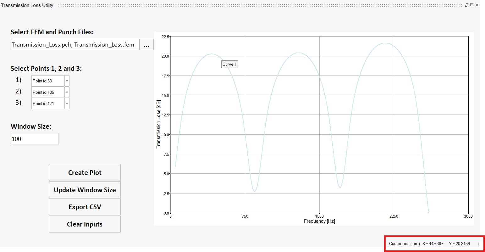

In Compose,
Transmission Loss = 20 dB at 450 Hz
Here, the results appear to match closely.

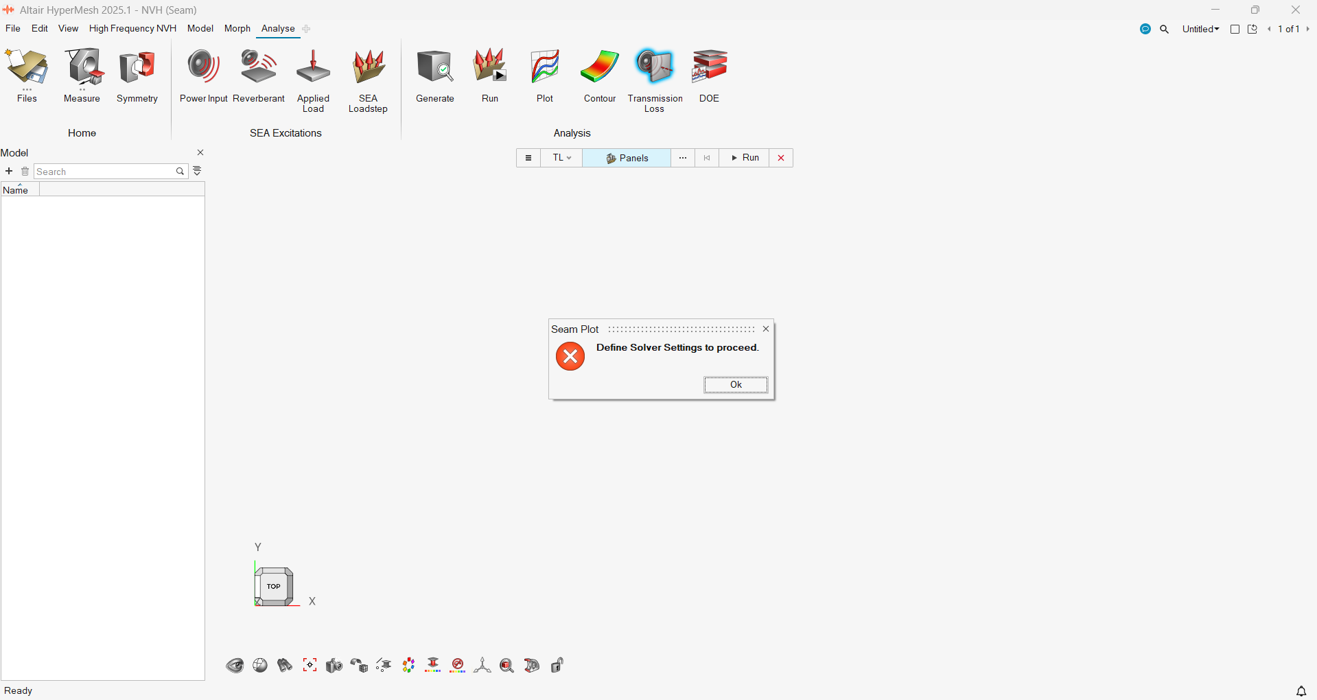

Also, how can I obtain the results using the Transmission Loss option in HyperMesh NVH (SEAM)?
When I try to run it, it shows an error.
