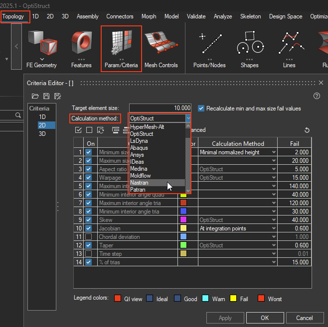

Hello.
My client provided me with a mesh that was run with Nastran.
When I run it with Optistruct, my calculation fails because some elements of my mesh don't meet the meshing criteria. This is strange, as the Nastran calculation works. The meshing criteria seem different and more restrictive with Optistruct.
With the Quality Index module, I can only visualize the elements that don't meet the criteria.
Is there a way to modify the meshing criteria in the Optistruct calculation script to make them less restrictive and better suited to my client's requirements?
Thank you in advance.
