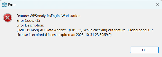

I think this situation was caused by:
Computer was still connected to AltairOne where you had an expired license.
By disconnecting (logging out) of AltairOne, the SLC software was then able to discover its own personal license.

I have tried the following:
This is the error message received in Analytics Workbench.
