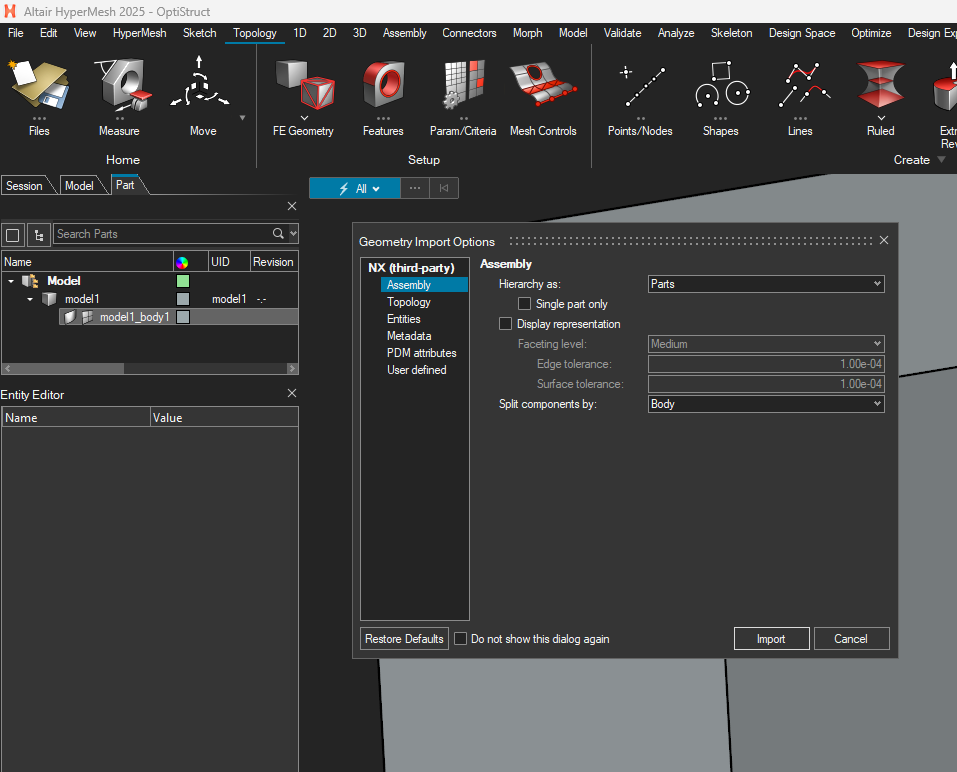

works for me

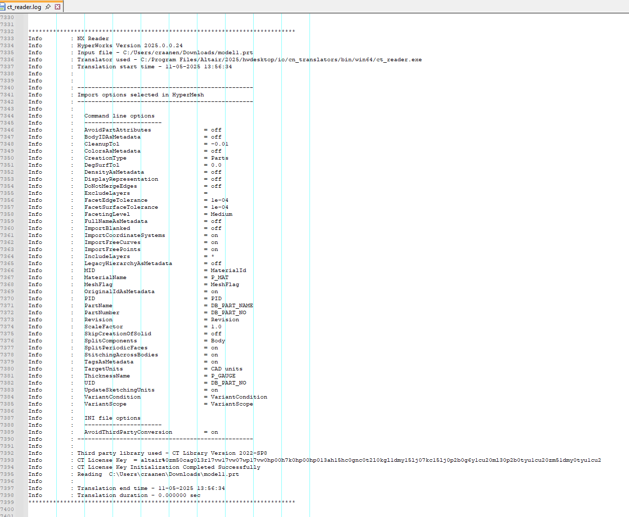

Can you check this message file? Should be in your working directory
@Jason_Craanen Thank you for your response.
I could able to get the message file and find below snippet.
Info : NX Reader Info : HyperWorks Version 2025.0.0.24 Info : Input file - C:/Users/babur/Downloads/nxassy_sample/model1.prt Info : Translator used - D:/altair/hwdesktop/io/cn_translators/bin/win64/ug_2506_reader.exe Info : Translation start time - 11-06-2025 07:24:54 Info :Error : UG version not supported. Info :Info : Translation end time - 11-06-2025 07:24:55 Info : Translation duration - 1.000000 sec
@Jason_Craanen : I experience the exact same problem and I also noticed the different reader. as for RBRRBR, my log file shows ug_2506_reader.exe.
