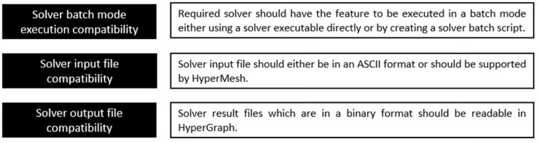

I hope that 'automating the design process' refers to performing an automatic design exploration using DOE/Optimization approaches in HyperStudy.
If that is the requirement, kindly refer the details mentioned below:
To check if FlightStream can be integrated with HyperStudy, one has to first check the pre-requisites mentioned below from the below blog.
If FlightStream meets the above listed pre-requisites, one can follow the process mentioned in the blog to integrate it with HyperStudy using the ‘batch script’ method.
