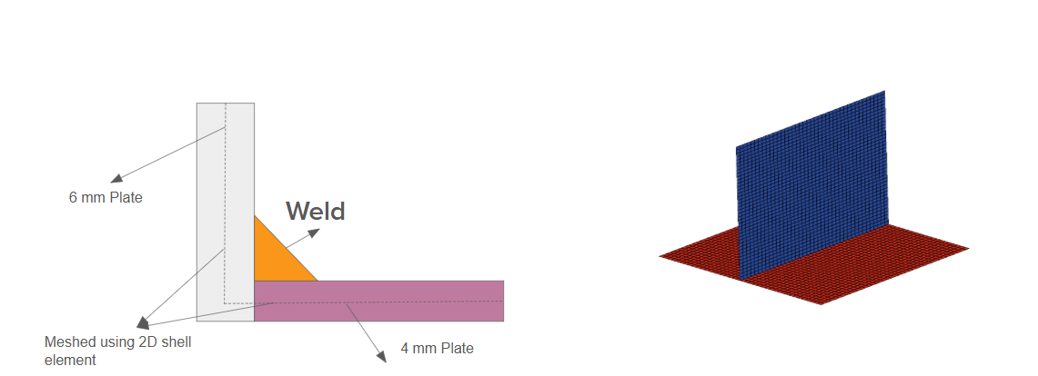

In the L-joint, the connection modeled as node-to-node between 6 mm( vertical)and 4 mm(horizontal). However, in the actual structure, only the 3 mm weld is present at the joint. To better represent the weld behavior without modeling it in 3D.what should i do ?
