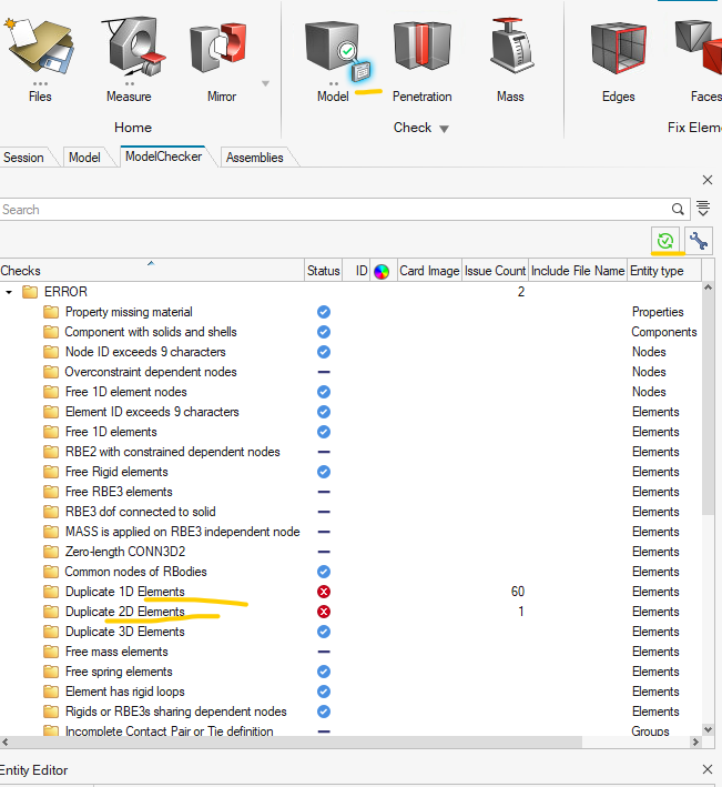

I would recommend to run the Model Check (https://help.altair.com/hwdesktop/hwx/topics/user_interface/model_check_run_t.htm?zoom_highlight=model+checker)

Very simple method: do equivalent of nodes and then "Check" element ⇒ Detect duplicated elements ⇒ Delete if necessary
You may use Check » Model Check
