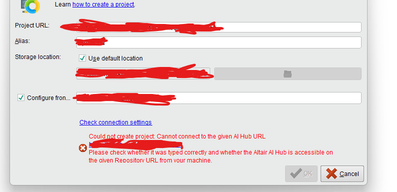

Hi,
I set up AI Hub on a remote server and created a project. I attempted to open the project in AI Studio, but I got an error saying it cannot connect to the AI Hub url, despite me being able to access it on a browser:
The server does have a custom certificate but I imported it into AI studio successfully.
So I tried cloning the project manually with git clone using the instructions found here:
https://docs.rapidminer.com/latest/hub/projects/index.html#connect
I was able to get a token successfully but I get a 500 error from git, indicating an internal server error. I looked at the aihub backend docker logs and found there was an internal error, I think the problem might be the line that says
java.lang.NullPointerException: Cannot invoke "java.util.Map.get(Object)" because "realmAccess" is null
Not sure what this indicates, maybe I misconfigured something with keycloak?
Here is the more of the logs:
