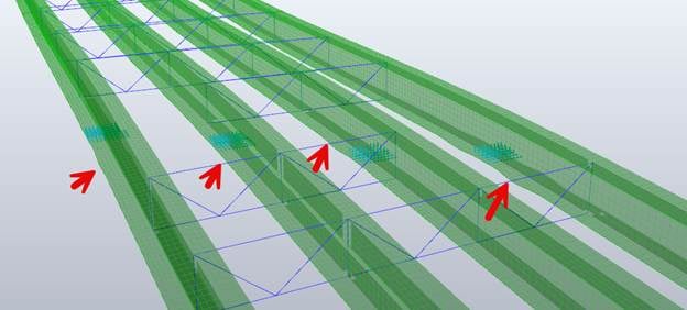

One way is to perturbate the model in such a way to introduce some form of geometric imperfection. Let’s use an example where a vehicle strikes one of the girders on the bottom flange and causes some lateral deformation. With that lateral deformation, the gravity loads will no longer be resisted by perfectly plumb girders, and this is something we could represent in our model without too much effort.

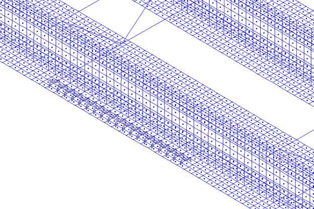

For the sake of this exercise, let us assume one girder had its bottom flange experience 57kips of lateral force in a concentrated area as shown below.

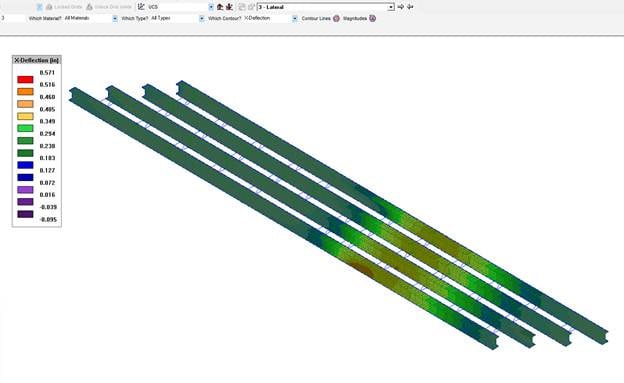

We can then run a linear static analysis on this lateral load case to compute the deformation.

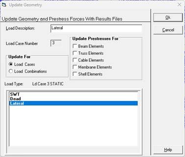

We can see the maximum X-deflection is 0.571”, which is about 40% of the original vertical deformation from a linear static analysis. The next step is to update the analysis model with the geometry from this deflected shape. We are assuming that the lateral deformations are permanent, and our new equilibrium shape will be that of the deflected model.

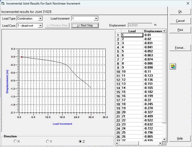

With the updated geometry, we can now run through a similar nonlinear, and observe the results. In this scenario we noticed nearly identical behaviour for most of the simulations on the undeformed geometry. With that said, when we ran the amplified (8x) load nonlinear static analysis, we did observe an earlier onset of ‘buckling’ behaviour for this model.
As we can see from the incremental results, the Z-deformation has a sharp increase at load increment 14, which would equate to a load factor of approximately 3.7 times the original load combination.
What Have We Learned: After introducing a geometric imperfection, the Nonlinear Static analyses, predicts that buckling will occur at approximately 3.7x of the “Dead + Self Weight” Load Combination.
