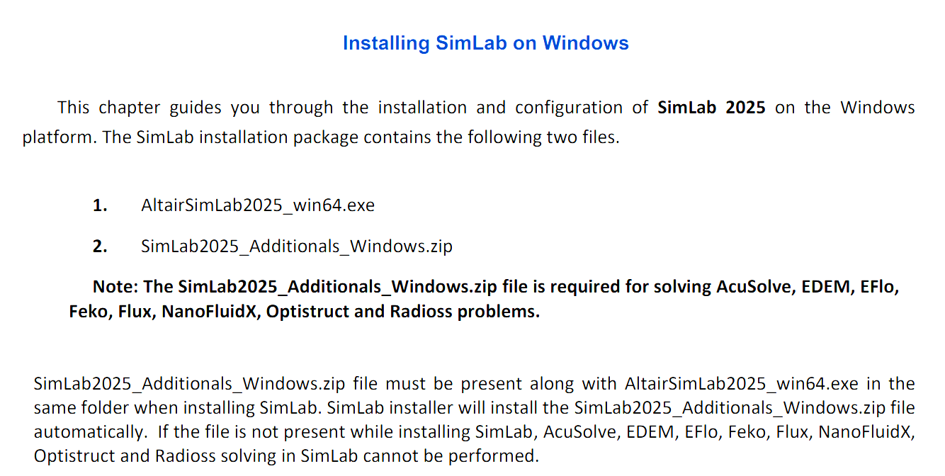

I have downloaded simlab additionals but still not able to find the installation file in the downloaded zip folder can anyone help me to find the installation file. I am using 2025 version
Hello,
Do you have the additionals .zip file in the same folder location as the .exe file before installation? When you run the .exe file to install SimLab, the installer will automatically install the solvers located in the .zip file. From page 4 of the SimLab installation guide:
Hopefully this helps! Thanks!
